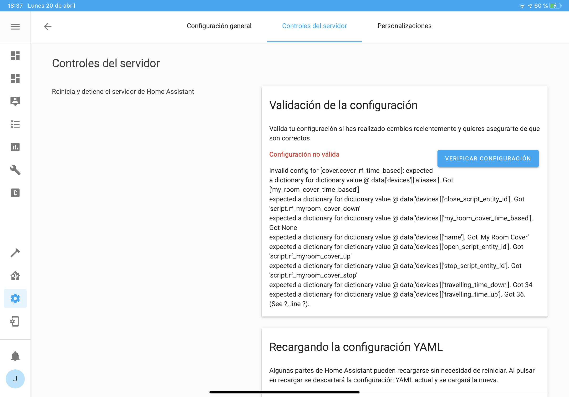

Hello.
First, I want to thank you both for your custom_component.
I’m trying to install it, I need RF version because I have 3 switchs. I write the example configuration, but I receive this error. I’ve tried to change indentation, but doesn’t work.
Thank you in advance again.
I was just about to ask for this and thank you for the quick fix.
There should be one more tab on the configuration:
cover:
  - platform: cover_rf_time_based
    devices:
        my_room_cover_time_based:
          name: My Room Cover
          travelling_time_up: 36
          travelling_time_down: 34
          close_script_entity_id: script.rf_myroom_cover_down
          stop_script_entity_id: script.rf_myroom_cover_stop
          open_script_entity_id: script.rf_myroom_cover_up
          aliases:
            - my_room_cover_time_based
Thank you so much. :sweat_smile:
