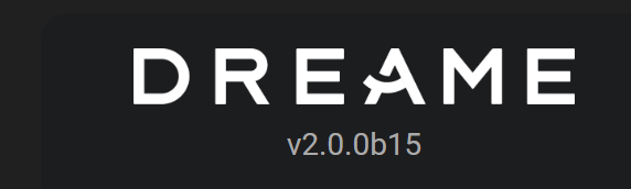

I have the latest beta version, and latest HA build installed
Thanks for the input. 2.0.0b16 installed. Indeed it is connected now. Discovering it now!
