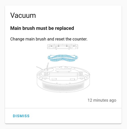

Persistent notifications with error reporting
Persistent notifications with extracted resources on specific events as implemented on official App.

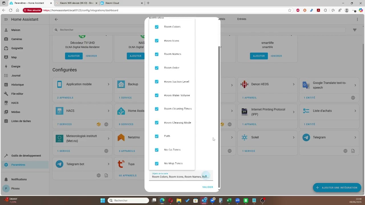

I get stuck on configuring the integration - it says “Error Config flow could not be loaded: {“message”:“Invalid handler specified”}”

This issue is related to Home Assistant with cv2 on python 3.10.
You can find more about:
https://github.com/Tasshack/dreame-vacuum/issues/1
https://github.com/home-assistant/core/issues/74566
I think i will get rid of the cv2 completely for fixing this issue, but if i do that either image quality will be lower or the render times will be higher and i cannot decide which one to choose.
