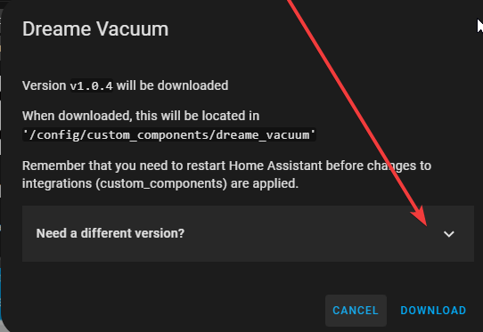

Not sure but may be related to this;

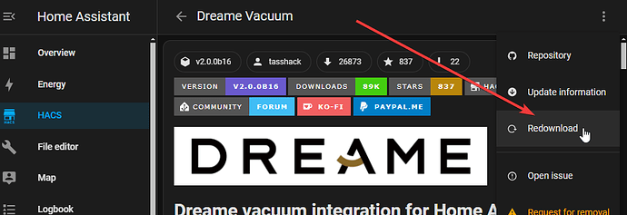

Just installed V2.0.0b16 from Hacs and so far so good with L20 Ultra :grin:
In hacs press 3 dots, select Redownload and choose the beta version
I have installed the version v2.0.0b16 and imported my Dreame l20 Ultra.
