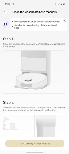

I have another question, I didn’t find a way to start the washboard base cleaning process in Home Asisstant for my X40 Ultra. Are there any plans to add this in the future? I would love it to use Home Assistant to do all sort of maintenance on my vacuum, including cleaning the dock.
