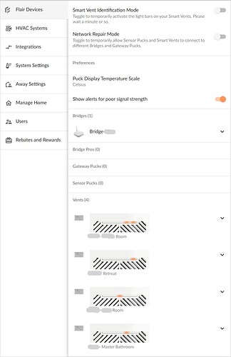

Hi, I tried adding the integration after adding it in HACS.
I added the Client ID/Secret and get this error: No structures discovered

Have you set up a Flair structure via the Flair mobile app and added all of your devices there?
I added the Bridge and 4 Smart Vents. and connected EcoBee. The EcoBee Smart Sensors not yet. Could be this is the reason ?
Nope. As long as you set up a structure within the Flair app, the integration will pull in any Flair devices that are setup within that Flair “structure”.
Can you provide a screenshot of the main page within the Flair mobile app?
Thanks. Today I should get the EcoBee Sensors, I assume it will solve the issue.
Not having ecobee sensors shouldn’t be preventing you from setting up the Home - some users have just a bridge (or puck) + vent(s) and then use home assistant to automate manual control of the Flair vents using temperature sensors they have integrated within Home Assistant (from brands/types that Flair doesn’t directly support themselves in their app/platform).
You should click on “Resume Setup” in the first screenshot you shared so that you can finish setting up the Flair “structure” (what they call Home in the app, but structure in their API responses).

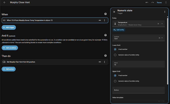

Hi Robert, so I’m doing a simple Automation with this and it doesn’t seem to want to work from what i put in. But when i manually Run the action it works.
