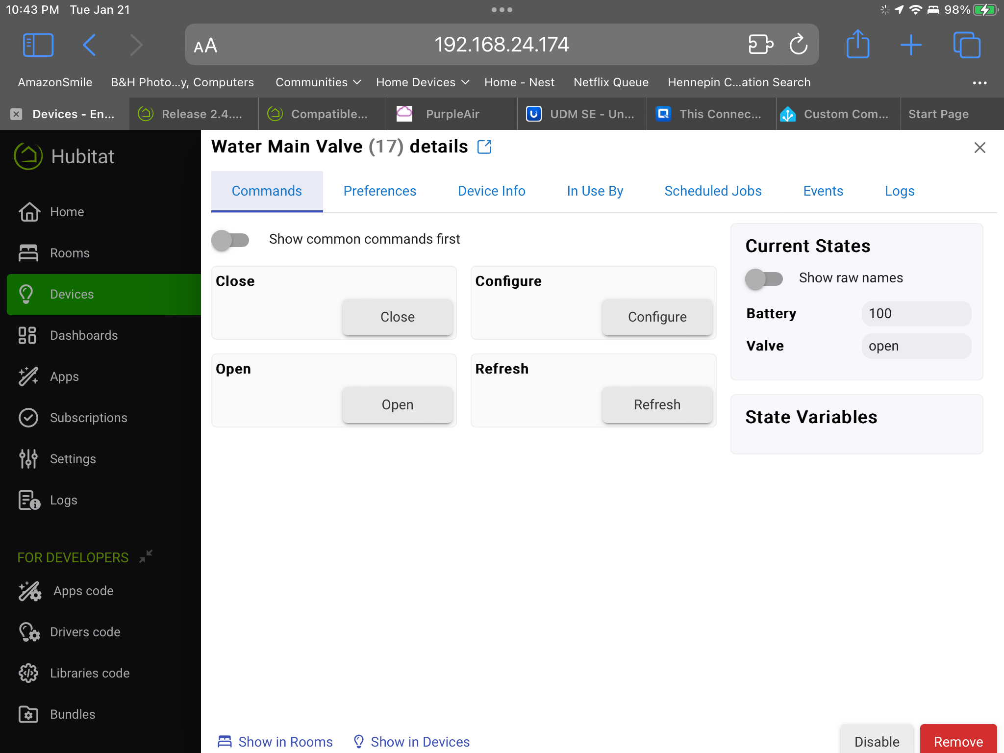

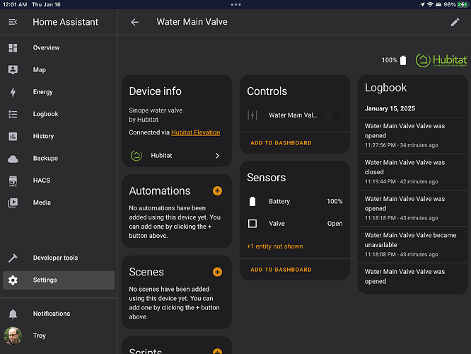

Did something change in one of the recent updates around valves? I used to be able to control my water main (Zigbee on Hubitat) through this integration, however now the control is no longer available but it still shows the correct state of the valve sensor.
My core is 2025.1.2 and version 0.9.41 of this integration, and my Hubitat is 2.4.0.143
The last updates dealing with valves were in July, but I’ll take a look. Do you see any Hubitat-related initialization errors or warnings in the Home Assistant log?
I haven’t seen anything in either logs. Thanks

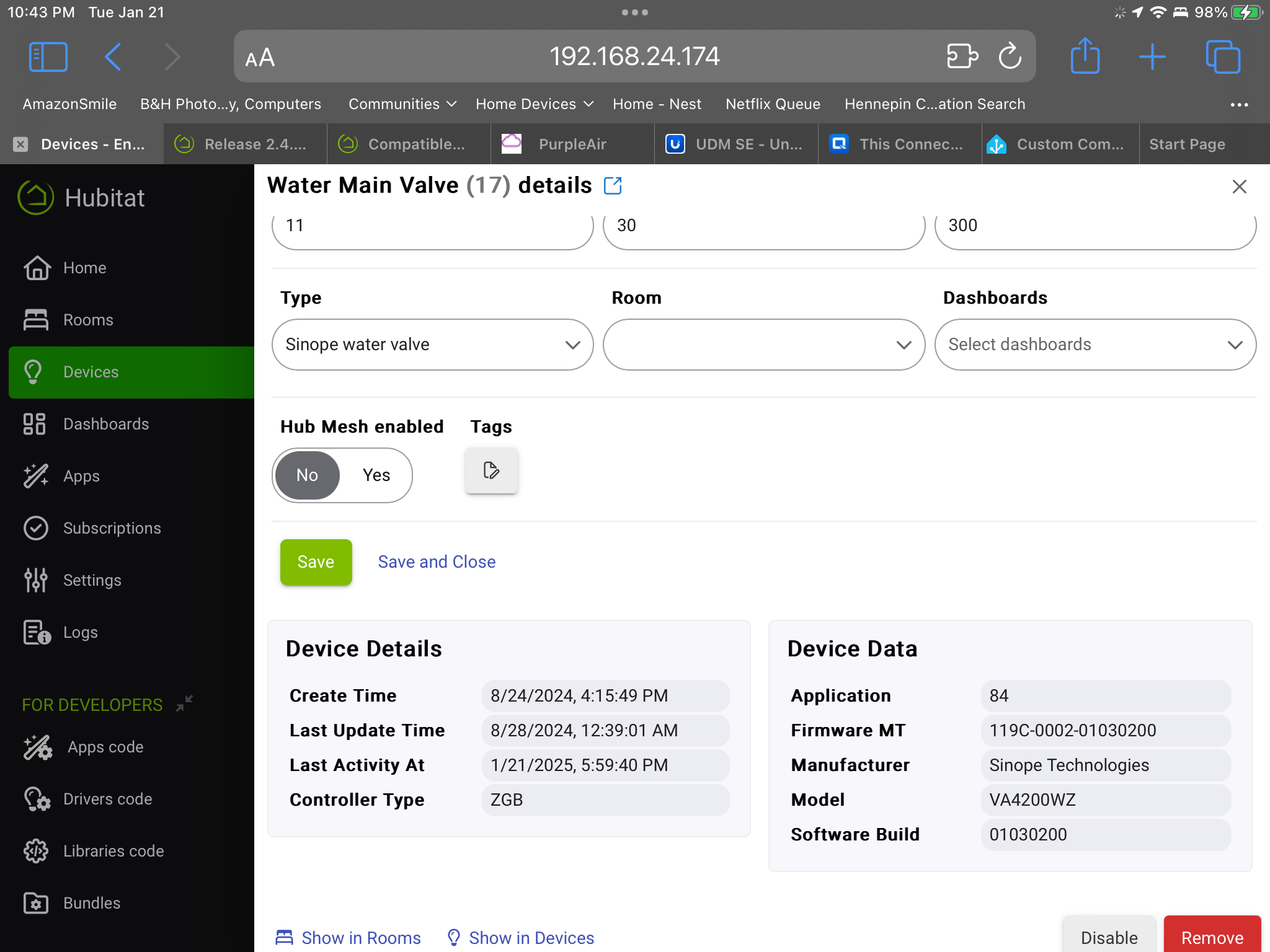

Can you grab the capabilities for the valve and post them here?
Not sure how to find the capabilities I know it’s in the driver but I’m using the built in driver so can’t see the code.
The instructions for that are in the page I linked to. :slight_smile:
Sorry,
[{“capabilities”:[“Configuration”,“Actuator”,“Refresh”,“Battery”,{“attributes”:[{“name”:“battery”,“currentValue”:“100”,“dataType”:“NUMBER”,“values”:null}]},“Valve”,{“attributes”:[{“name”:“valve”,“currentValue”:“open”,“dataType”:“ENUM”,“values”:[“open”,“closed”]}]}]}]
Hello, just ran across an issue with some temperature sensors that I just added to this integration. They are integrated just fine and show correct values but as soon as the device updates (whether the temp changes or not) the value is converted much higher than it should be. The value in question should be output in Fahrenheit and it does when I refresh the integration but after an update is sent it will take the Fahrenheit value and convert it to Celcius which makes the temp 150-160 degrees. If I check the sensor in Hubitat it shows the correct Fahrenheit value. Any help would be greatly appreciated.
Yay, Hubitat finally added a virtual valve device, so I can finally test these things. :smile: It turns out there was an error happening during startup that was breaking valve controllers. v0.9.42 has a fix – give that a try.
