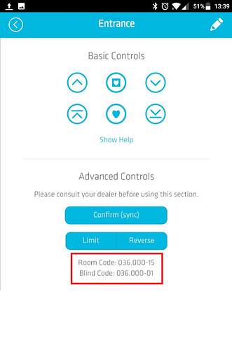

blind_code (string)(Required)
The blind code. - this is available from the NeoSmartBlind app
Ensure you add the trailing ’ - ’
