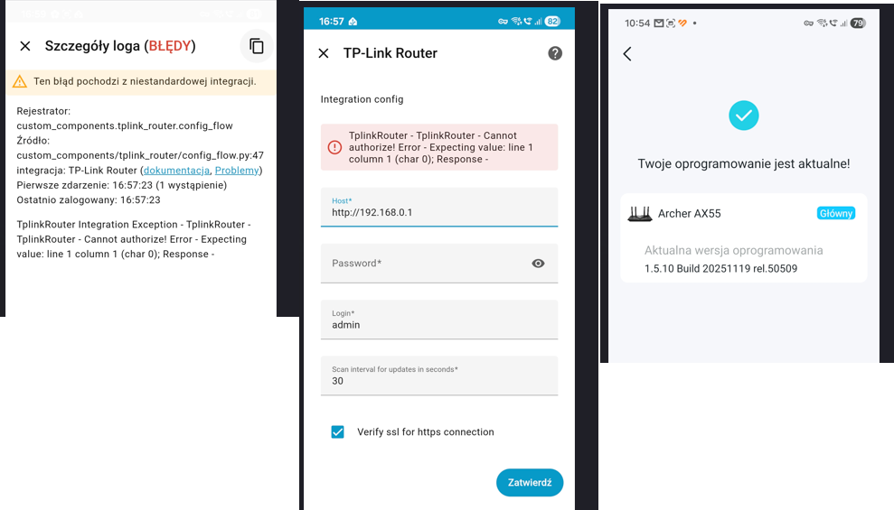

I have a TP-Link Archer AX55 router and I can’t connect to your integration. I get this error.
You may have updated the router firmware - the new deco firmware may not be supported
Have you tried - Cannot authorize! Error after Firmware update · Issue #220 · AlexandrErohin/home-assistant-tplink-router · GitHub ?
I have the latest version. Will you be updating it, or is there no hope?
Have you tried this fix from comment Cannot authorize! Error after Firmware update · Issue #220 · AlexandrErohin/home-assistant-tplink-router · GitHub?
As there are more than a hundred router models - I cannot support all of them by my own. If your router doesnt work with this integration it would be great if you could add the support - here are the examples TP-Link-Archer-C6U/CONTRIBUTING.md at bd42beebcbe39abc823f00a83ec6540f305e10cb · AlexandrErohin/TP-Link-Archer-C6U · GitHub

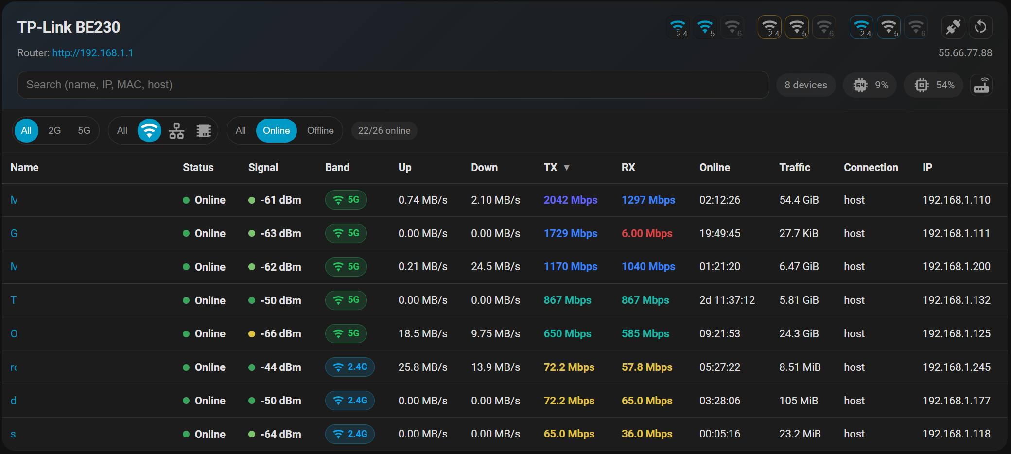

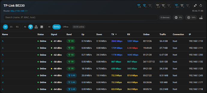

Hey everyone! I was looking for a more detailed client list for home-assistant-tplink-router in Lovelace, so I ended up building a small card for my own setup, and I’ve now made it public. It includes a client list with filtering and multi-sort, plus a few handy router actions.
It is waiting for HACS approval. You can already use the custom repo
If that sounds useful, feel free to check it out: GitHub - hepter/ha-tplink-router-card: Home Assistant Lovelace card for TP-Link Router (tplink_router) that shows live client list, filters, sorting, and router actions.
Hepter this is really good just installed it on my HA gives me loads of info of what is connected to my TP-link Router thank you

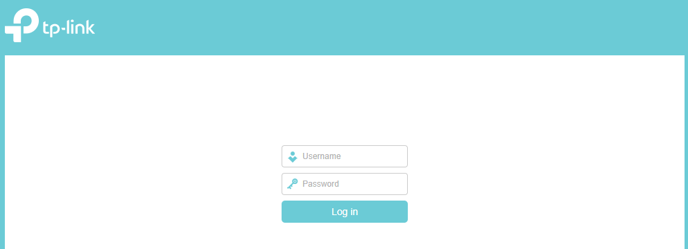

I’m trying to add my Archer VR1210v to HA, but I get the error:
TplinkRouter Integration Exception - ('Connection aborted.', BadStatusLine('18\r\n'))
I’m connecting through http (https local management not enabled on the router) and I have a custom local user and a different subnet from standard 192.168.0.1/24 or 192.168.1.1/24, so I specified both IP/username/password, but it doesn’t work.
Firmware Version is 2.0.0 0.9 v6041.0 Build 221027 Rel.12900n
Hardware Version is Archer VR1210v v1 00000001
Login screen on the router is the following:
Can you please help?
