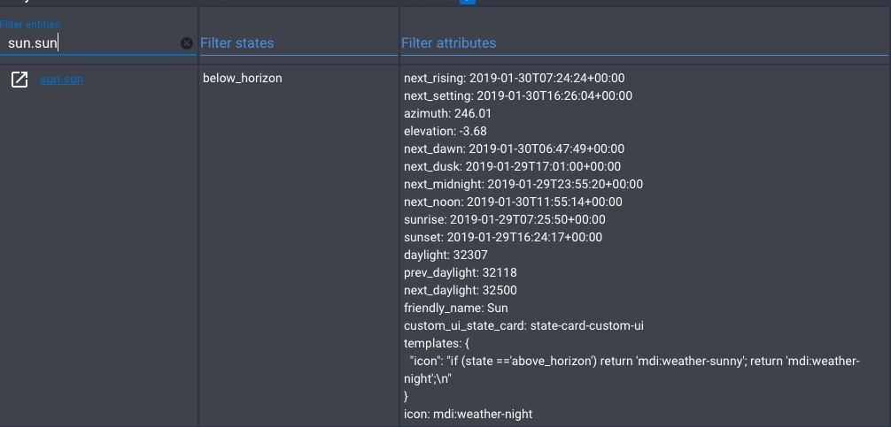

nextSunSet = new Date(this._hass.states[this.config.entity_sun].attributes.next_setting).toLocaleTimeString(this.config.locale, {hour: '2-digit', minute:'2-digit'});
my sun.sun is:
what is being passed into entity_sun in your lovelace config ? also what is being passed into the locale flag?
the exit same setting as for the card with the other Lit settings, which shows immediately with all correct info if I load it again:

Well, that error is basically saying that the value in [this.config.entity_sun] is undefined… which can either mean that the value being passed in the lovelace config is not an entity in home assistant or if it is an entity, that the entity’s value is undefined. based on your screenshots you are passing in sun.sun and sun.sun has a value (and attributes). not sure what the issue is … all that seems correct.
Try removing entity_sun from your lovelace config. That should prevent it from trying to display the sunset information. Just to see if the rest of the card works or if there is another error being masked by this.
sure will try, and the entities are indeed correct, see my ‘old config/lit’ card, thanks for having a look:

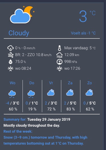

what surprises me is that with the sun config commented out, the old card still show the sun setting/rising :wink:

Finally Success!
Thanks for your help and patience. I’m embarrassed to say I spent 5 days on and off and to get here feels great.
Thanks very much m.p. This is a nice piece of work and I learned about all sorts of things in HA trying to figure out how to make it work.
Bart
Awesome!, Glad you finally got it working .
thought it to be a cache issue maybe, so cleared the cache, updated the version number, restarted…
still showing the sun icons ?!?
of course it i the config of my dark-sky-weather-cards.js, and it is a module isnt it? just like the ;old’ card?
Im stumped…
