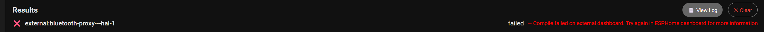

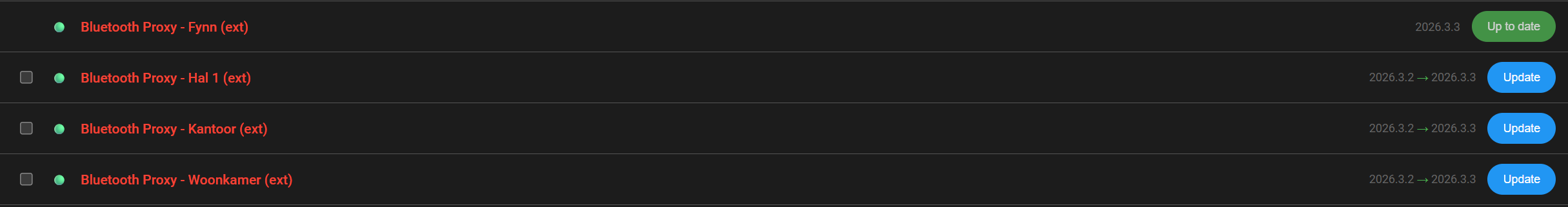

I have got 4 bluetooth proxies. All give the same error:
Building from the esphome page works just fine.
Don’t exactly know why they are red, while others are white, but haven’t searched the github yet for that :wink:
they are red because update failed, this is documented in the readme.
