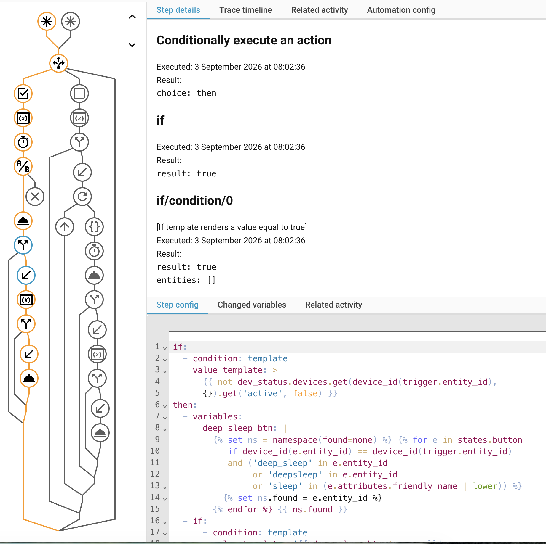

I’ve noticed that one of my devices (that sleeps for 30 minutes before taking samples for 10 seconds) does not receive updates.
Looking at the automation trace, I see that it is triggered when the device comes on line, but from my limited knowledge of how to read the trace information, it does not seem to ever look to see if the device has a pending update.
What do I need to do to make sure that, where there is an update available, that this is applied when the device wakes up?
(I can provide any other information to help look at this.)

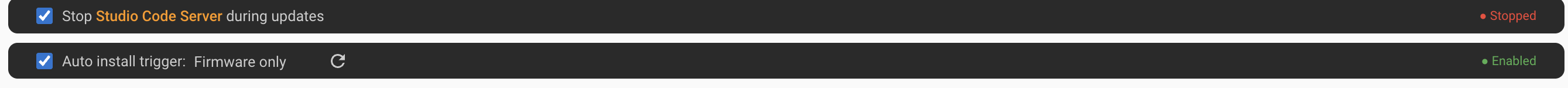

  2. Is auto-install enabled, and is the scope set to something that includes firmware updates (Firmware only or Firmware + Project)?

  1. Auto install is enabled:

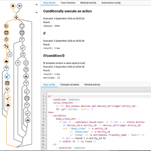

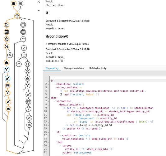

  1. I adjusted the delay to 20 seconds. This is the trace after the automation ran - basically the same as before:
My understanding is that the orange line is the flow through the automation. Therefore it was triggered when the device came on line. The automation delay of 20 seconds occurred.
It then (I think) checks to see if the device is still active, then looks for the ‘deep sleep’ button (which it finds) and then ‘clicks’ that.
From my understanding of the automation code is that there is nothing in that whole ‘trigger’ path that checks for a firmware update.
Susan

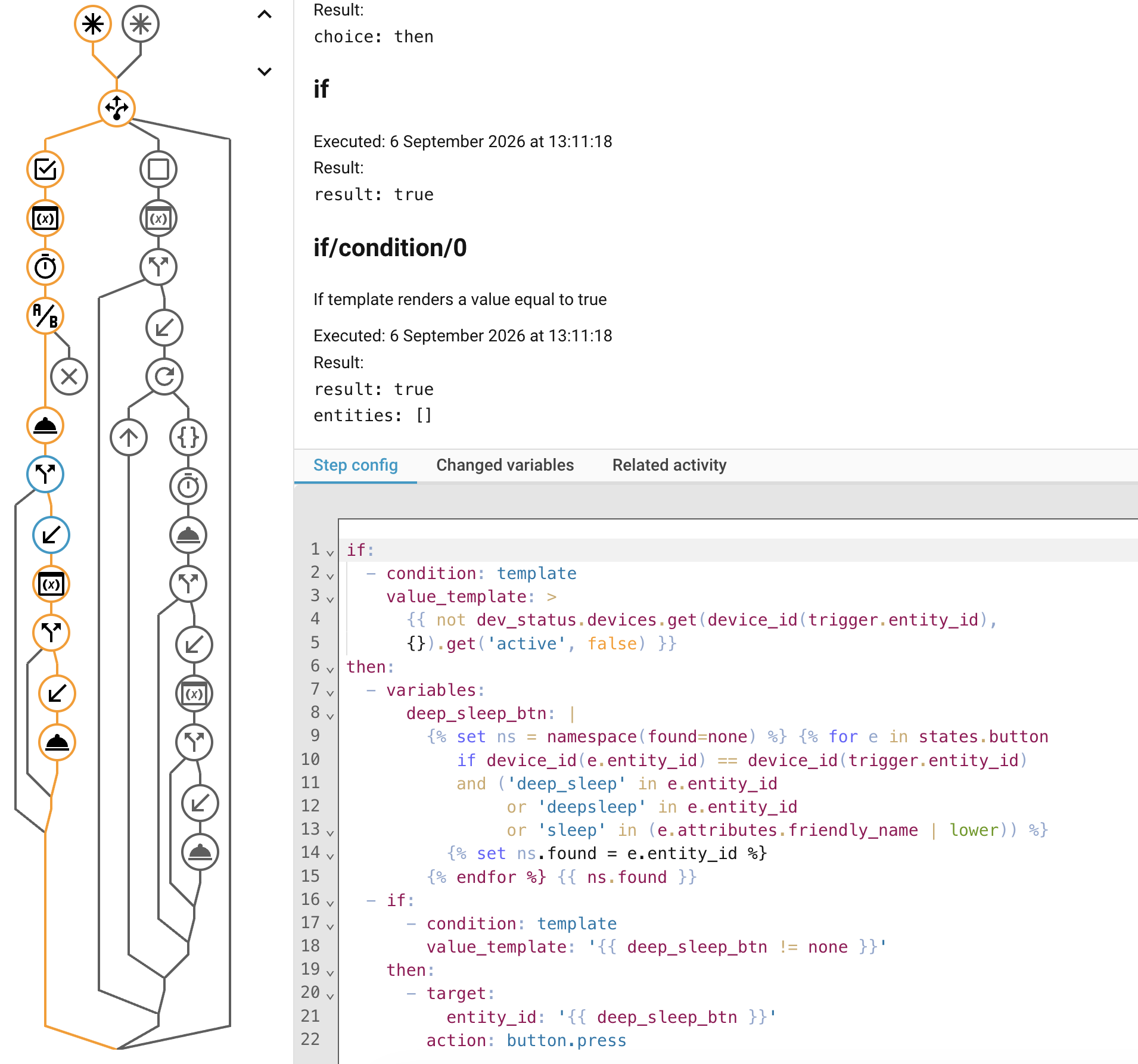

After recording something, the automation then waits for the 20 seconds and again this seems to e occurring.
However in that whole ‘condition’ path, I can’t see where it looks for a firmware update.
The other condition sequence (from the update manager completing) there is a list of devices created that is iterated to perform the update:

This path checks if a device is ‘active’ (at least I think that is what it does’) and skips it if it is not - and my filament-dryer device is almost certainly not active when it is checked.
Is it possible to do two things here:
  1. if the device is not active, then put it in a list (???the ‘forced update’ list???) to be looked at the next time the device does connect, and
  2. in the ‘wake’ path, see if the device is on that list and update it if it is before sending it back to deep sleep
Thank you for looking into this for me - much appreciated.

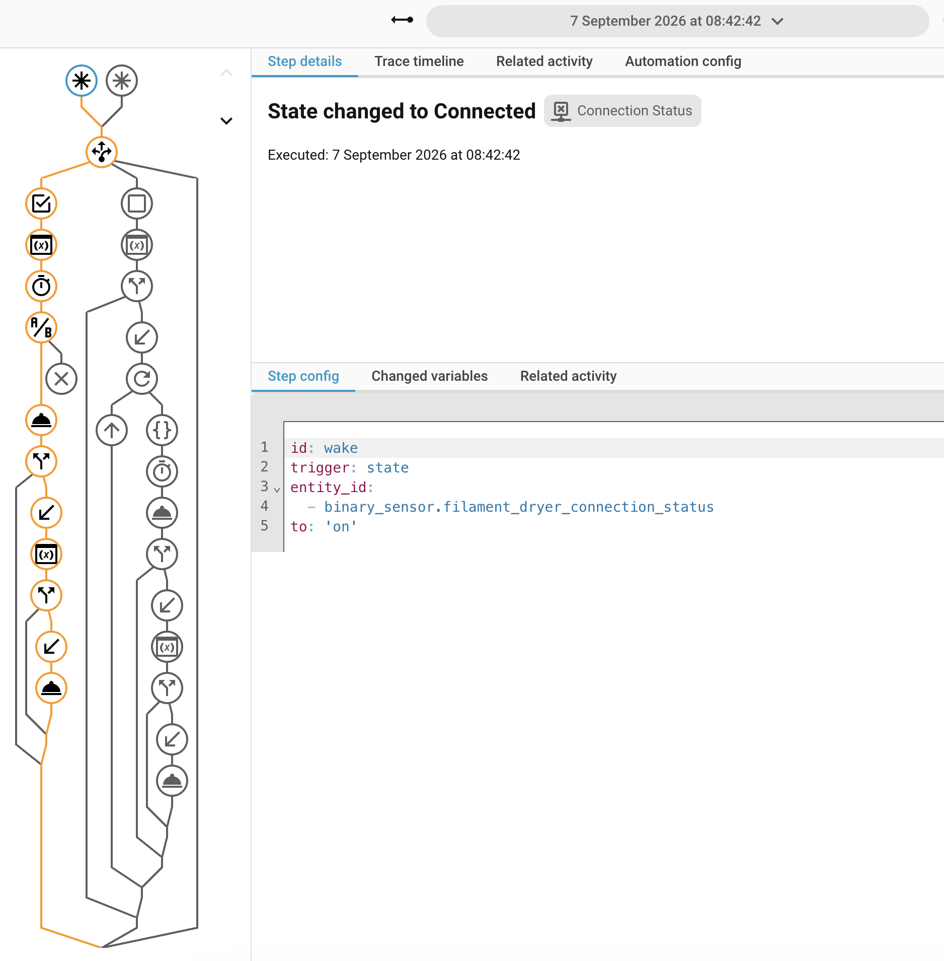

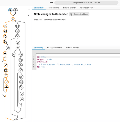

Also just did the reload as requested. The device came online a bit after that:
The automation was triggered but it didn’t perform any firmware update and the path followed (in orange in the image above) was the same as before.
Susan

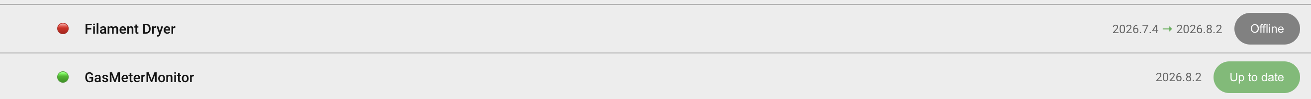

  1. First, a quick visual check, is filament-dryer’s name shown in red in the panel? (according to your screenshot, it’s not). It’s possible a previous update attempt failed and the device is now flagged internally, which permanently skips it from auto-update until a manual update succeeds. This would show as a red device name in the panel. Another way to check this (if you have access to the .storage folder in HA) is to open the file esphome_update_manager.settings and see if “failed_devices”: {} is empty or not.
