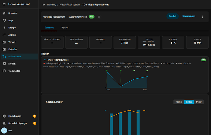

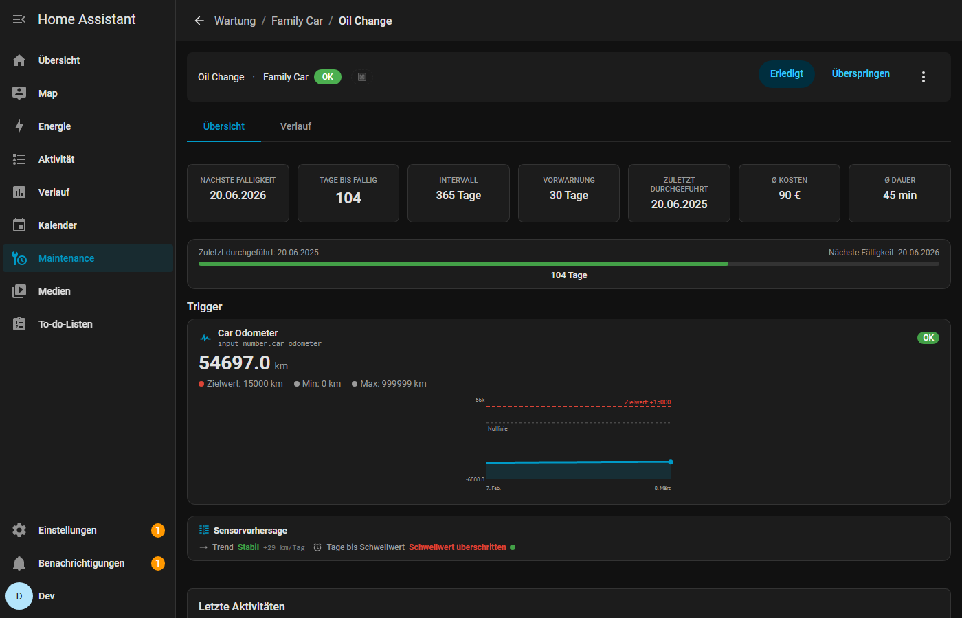

Task Detail with Sensor Triggers
Each task has a detail view showing its full configuration, history, and — if sensor-triggered — a progress chart tracking the sensor value over time. Here’s a task triggered by a counter sensor. The chart shows the value accumulating since the last service, with a prediction line showing when the next service will be due based on usage patterns.

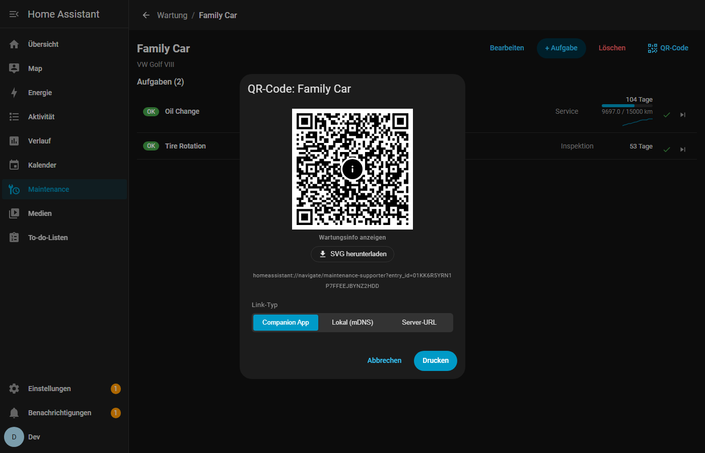

QR Codes for Physical Equipment
Generate QR codes for any task, print them, and stick them on the equipment. Scanning the code opens the task directly in HA — or auto-completes it, depending on your configuration. Great for shared households or maintenance teams where not everyone lives in the HA app.

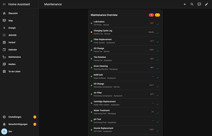

Lovelace Card
Don’t want the full panel? Embed a compact maintenance card in any Lovelace dashboard. It shows status dots, due dates, and quick-complete buttons for each task. Fully configurable — filter by object, group, or status.

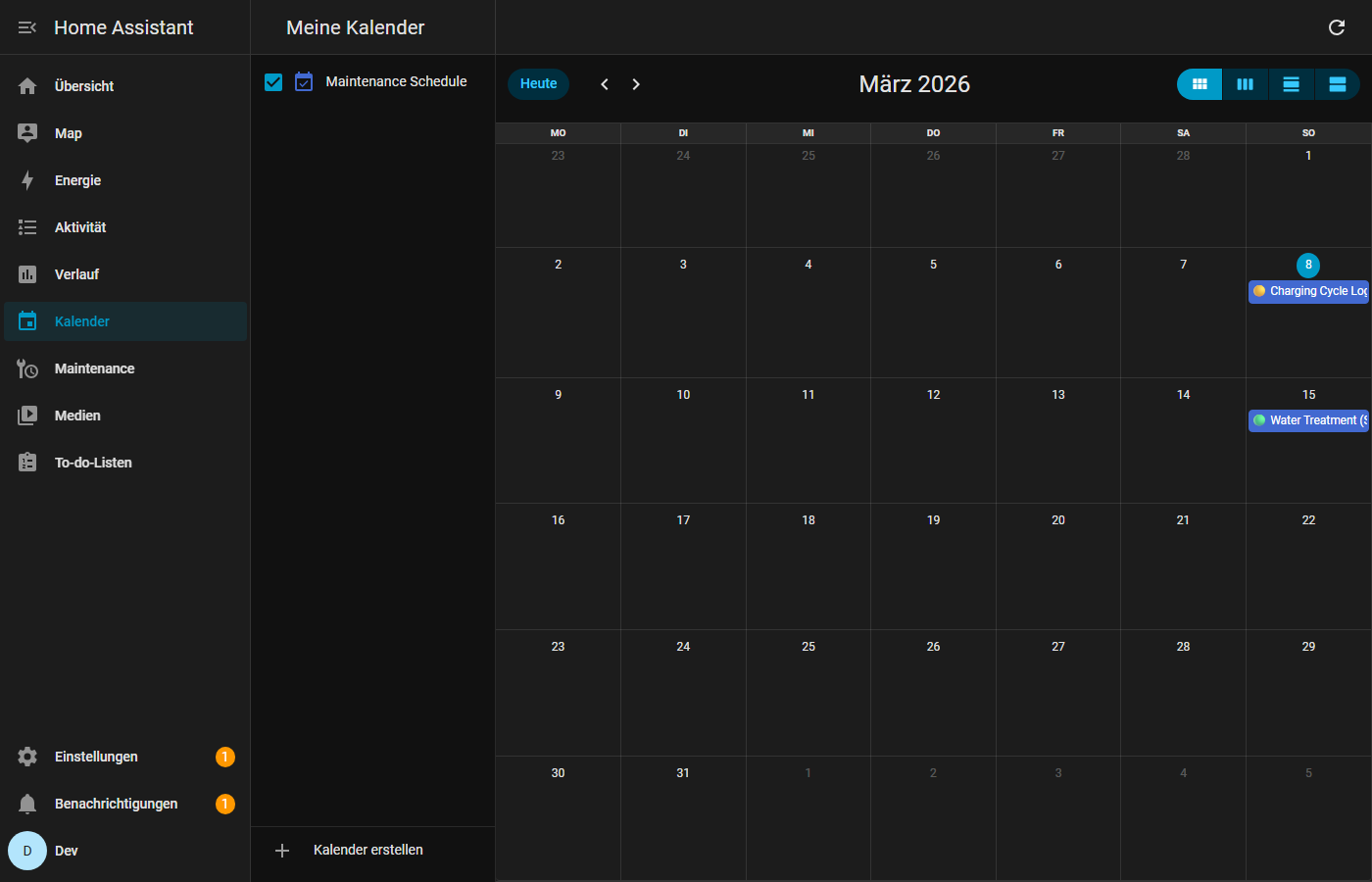

Calendar Integration
All upcoming maintenance events appear as a native HA calendar entity. View them in the built-in calendar view, sync to your phone, or use them in automations.

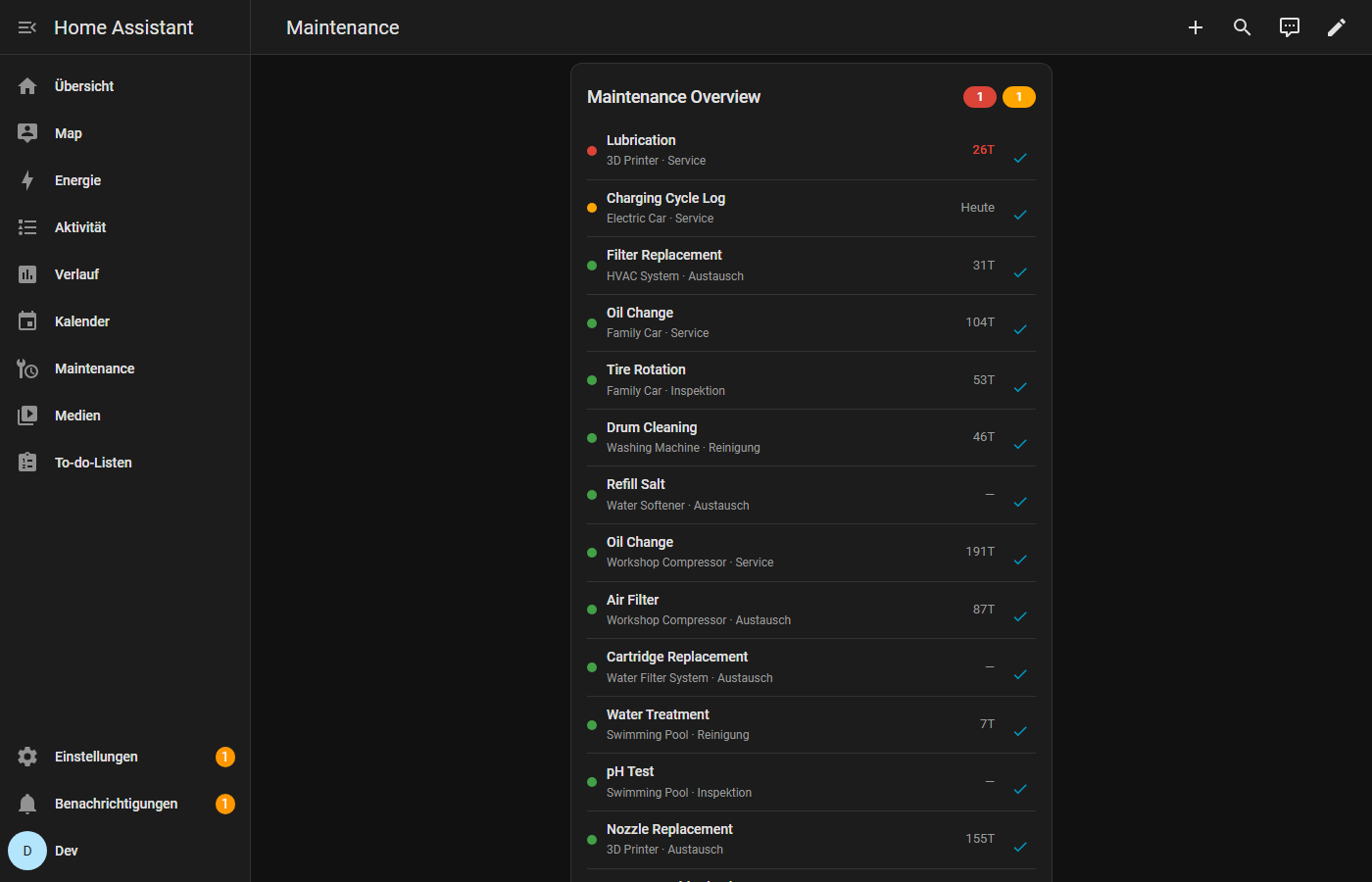

I have been obsessed with this for the last 2 days. I have replaced my "house chores" card on my kitchen dashboard with the maintenance tasks. However. I have one thing that is rubbing my brain the wrong way lol.
Can you help me understand why the pool check chlorine, due in 3 days, is in front of the check ph for the hot tub due in 1 day? Is there a way to force the due date to be the primary sort?
Love this so far.
Would you be upset if i submitted a feature request via github for a "one time maintenance" task?
:slight_smile:
Hey @brunkj — love that it clicked so fast, and thanks for the clear write-up (the screenshot helped). Two things:
The sort — fixed in v2.3.7 (just released).
You diagnosed it exactly. The card was sorting by status only (overdue → triggered → due soon → ok). Within the same status it fell back to the order tasks arrive from the backend (roughly object-creation order), so two "due soon" tasks weren't ordered by due date — that's why pool chlorine (3 days) sat above the hot-tub pH
(1 day).
v2.3.7 adds a secondary sort: within each status, soonest-due first (tasks with no due date go last). So your hot-tub pH (1 day) will now sit above the pool chlorine (3 days). Update via HACS, restart HA, and hard-reload the browser (Ctrl+Shift+F5) so the new card JS is picked up.
I kept status as the primary key on purpose — that way an overdue or sensor-triggered task always surfaces at the top instead of being buried under something merely "due soon" with fewer days. If you'd actually prefer a pure due-date sort that ignores status, say the word and I'll add it as a card option.
One-time maintenance — yes, please file it, and let's design it together.

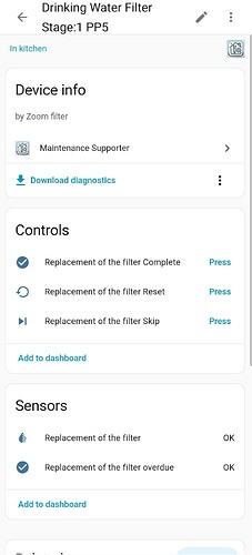

I start usuing it and i have some suggestions to shear:
  1. some home unit like multi stage filter have multi filters with different due date to change, suggestions to add one custom for the unit and include all the stages but different tasks
  2. for some maintenance replacement good to include the remaining days count down in the integration section rather than OK statues to use it in bars
Thank you again

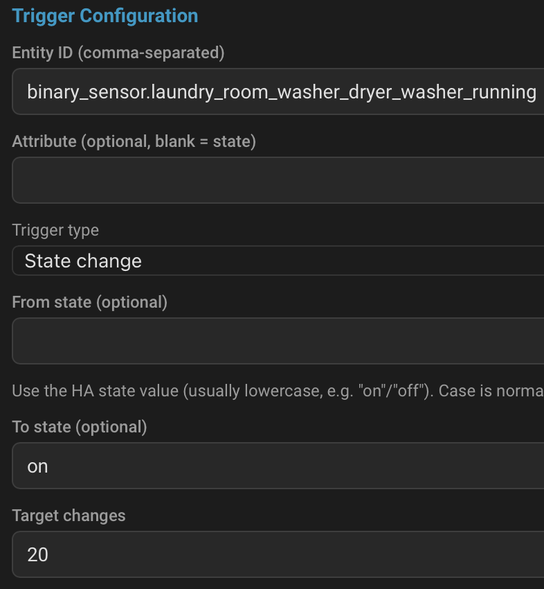

This is exactly what I was looking to get done! I've gone on a little NFC tag with some removable labels all over the house. Wife wasn't too happy until we went a 2 weeks and the place still looked semi decent. Now she's asking me to add to it!
I have a dishwasher counter that does a delta since I have a sensor that shows the run count. Which is awesome and I get a indicator showing how many runs till a cleaning cycle is needed.
Then I have my washer but instead of having a sensor for run count I had to make a binary sensor. Using the example, for a washer go figure, from your readme. I set that up and I'm not getting a run count. Is that right? I kind of expected to see little line with X / 20 like with the dishwasher. I can't even tell how many times it's tripped.
And the latest update now shows what I was expecting.
Thanks!!

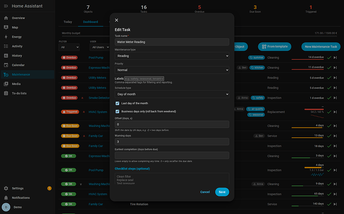

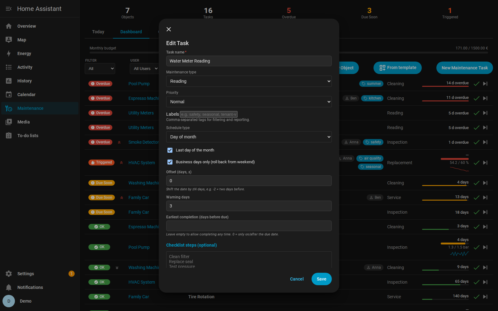

v2.18 (today) — meter readings & end-of-month scheduling
Straight from a GitHub feature request (#83):
  • A new Reading task type for recording values — utility-meter readings, level checks. Pairs nicely with completion photos (snap the meter display).
  • End-of-month scheduling: last day of the month, last business day, and a ±N-day offset on every calendar pattern. "Two days before the last working day of the month" is three clicks now.
  • Business days are Workday-aware: if you have HA's Workday integration configured, public holidays and custom working weeks are respected automatically.
