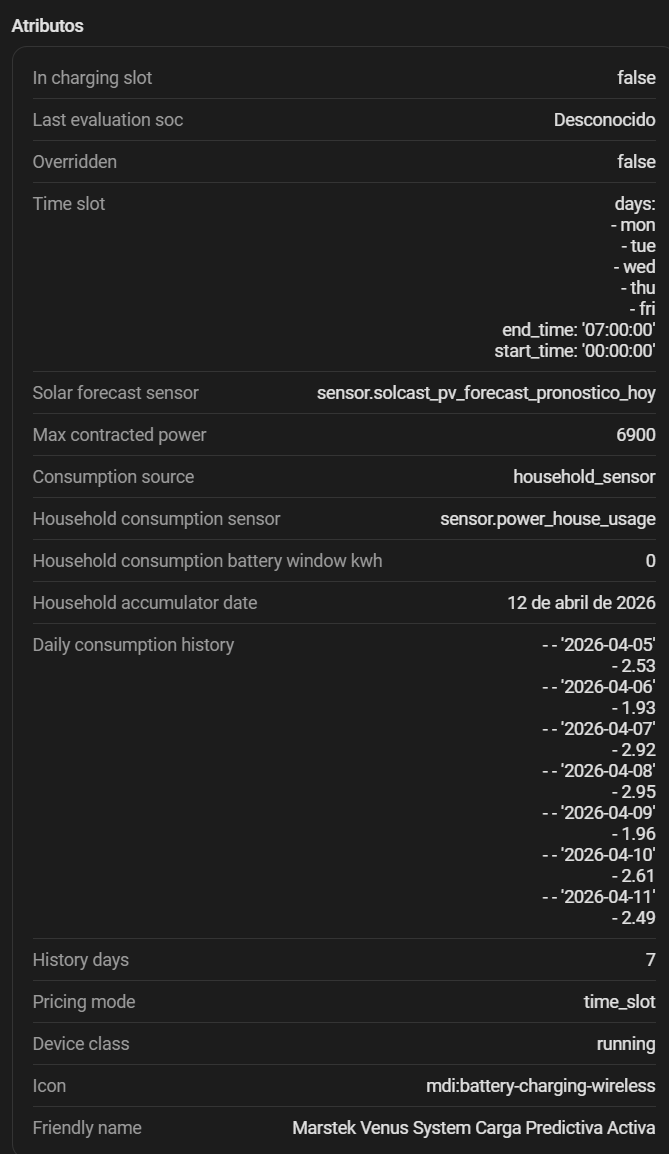

There are attributes in almost every sensor located in the diagnostic section of marstek venus system, if you click on the sensor, then the three dots, then details, you end up in a page like this:
