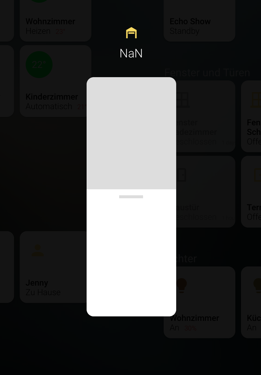

@fitim found out the problem and did a code change and release new version: https://github.com/DBuit/cover-popup-card/releases/tag/0.1.1
Thanks for your effort, but its causing still the same problem for me … :frowning:
Maybe Cache?
Are you using HACS?
Yes, I’m using HACS. My browser is Safari …
Can you try chrome? and check console if there are errors maybe? in safari / chrome
Neither firefox nor chrome are working. This is the error I get in the log:
Error handling message: invalid template (TemplateSyntaxError: unexpected char “'” at 131) for dictionary value @ data[‘template’]. Got “ha-card {\n background-color: var(–primary-background-color);\n border-radius: 15px;\n box-shadow: \n {% if is_state(‘sun.sun’, 'above_horiz\n”
