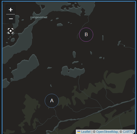

type: map
entities:
- entity: sensor.poi_1
- entity: sensor.poi_2
theme_mode: auto
Also, make these markers displayed with different labels by either using customized “friendly_names”:
Or use a custom card to have icons displayed:
type: custom:map-card
entities:
display: icon
color: red
display: icon
color: green
card_size: 10
nice - way better than mine! ![]()
