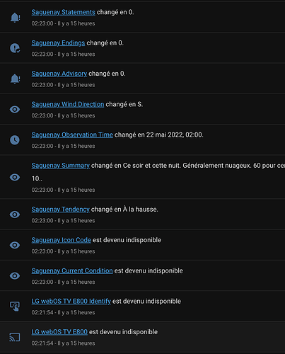

Can anyone help me find out why my home assistant supervised instance running on Raspberry P4 8Mb inside an Argon ONE M.2 Case, installed on Debian 11 is running high on CPU Temp at 2:25 a.m. ? Any idea what process is kicking in at the same time everyday?
And while looking at the log, I can’t find anything that could trigger so much ressources on the cpu in the interval between 2:00 a.m. and all the way up to max cpu temperature.

What is the cpu and memory doing at that point, are there spikes there as well? Could it be something environmental, like physically warming it?
Glances(there is an addon) is able to show processes active and the cpu/mem use. I don’t know if you can record it, meaning you may need to be up watching when it happens. Or set up a camera to record the screen.
