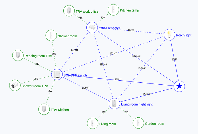

Hi Loui,
I have a Sonoff Zigbee USB 3.0 Dongle controlling three Danfoss Ally TRV’s over Z2M. I experienced the same problems you have described. One or more TRV became unresponsive through HA or directly through Z2M. Viewing the TRV’s on the ‘Map’ showed the unresponsive TRV was always directly connected to the coordinator. The TRV’s that remained responsive were connected through a router. Adding an additional router (Ikea - Tradfri) to prevent any of the TRV’s connecting directly through the coordinator solved the problem for me. My TRV’s have been rock solid every since. I can only assume the combination of the Sonoff dongle, Z2M and the Danfoss TRV’s invokes a software bug somewhere.
Hope this helps
Thank you so much! That’s what did the trick for me.
I actually noticed that the trv that wasn’t directly connected to the coordinator didn’t have any problems but I didn’t jump to the conclusion that that was the workaround.
