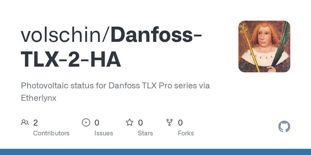

I wrote a completely new integration for Danfoss TLX Pro+ inverters (and IBC solar branded ones, maybe others also). You only have to connect your ethernet cable to your network. Often you already have this to export energy production to a central service.
No ESP or other adapters needed.
