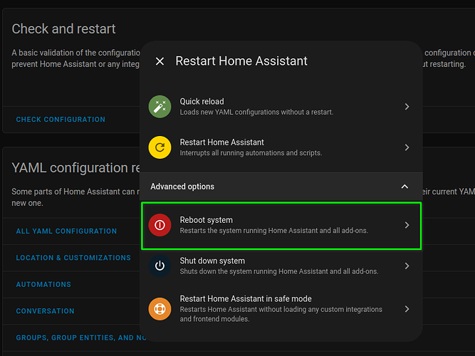

So, after some searching I tried restarting deconz. That didn’t work, but completely rebooting HA seems to have resolved the issue.
Same over here.
I suddenly lost status from most of my sensors (Aqara contact/motion sensors mainly) a couple days ago and the Deconz UI wouldn’t show any changes (version 2.28.1) :man_shrugging:
I tried to “Restart Home Assistant” like I usually do after the installation/update of some add-ons, reloaded the Deconz integration but it didn’t change a thing…
I had to choose “Reboot system” and sensors are reporting again :tada:

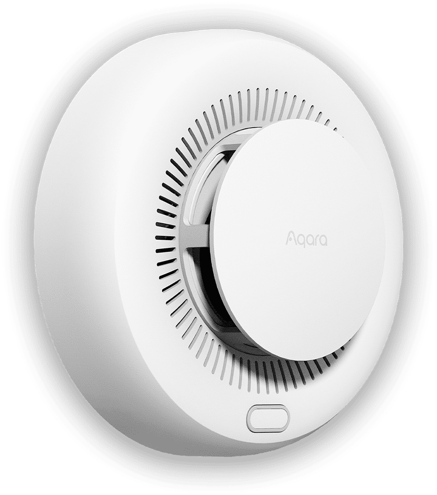

Anyone got the new aqara smoke detector SD-S01E paired with conbee 3?

Hi, I have just get also an Aqara SD-S01E, it seem that I couldn’t pairing using zigbee2mqtt and coordinator “zStack3x0” ( SONOFF Zigbee 3.0)
I got it paired with my conbee3 and used a custom ddf! It pairs very fast, at first i thought it didnt pair but it did and only saw it afterwards! Its nearly the same model as the JY-GZ-01AQ!

As you can see 2 posts over yours i got it already paired! Very easy, you dont see it only on the vnc overview (not in the phoscon app)! You need to install a custom ddf!
Apologies what do you mean by a custom DD?
DDF for Device Description Files
https://dresden-elektronik.github.io/deconz-dev-doc/modules/ddf/
