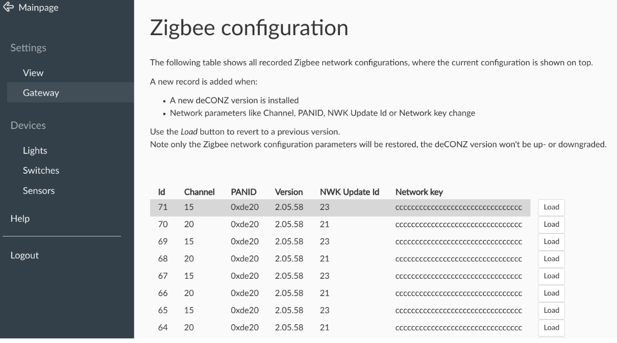

No luck yet. Tried various approaches, but so far nothing works.
When I tried to add one of the bulbs I had in the new rig, it came right in, with the old friendly name I gave it. So the Raspbee card do work. I had to add the bulb back in my primary RPi when I switched back.
So, a “connection” between the Raspbee and the devices (bulbs, sensors etc) is missing. Some hidden parameter I have to set (witch I don’t know about)? It seems that the Raspbee isn’t cloned exactly as the old one. “MAC-address” difference or something similar, a unik ID?
These are exactly the same:
  • Zigbee channel
  • Network id (PANID)
  • Network key
  • NWK Update Id
I have restored snapshots and Phoscon backups in various ways, this first, then that, that first, then this and so on.
I guess I don’t have the necessary knowledge to go forward with this problem.
It should be easy though. If you want to migrate, or the Raspbee card dies (it may very well do so), it shouldn’t be too complicated or take too long to set up. But as it is now, it seems (to me) impossible to do this without considerable work (pairing every device again).
Which in your case would be impossible since the location is far away.

Just to be sure - did you try this?
