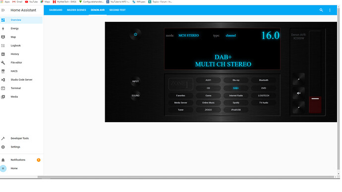

i have installed this card.
problem is that lots of button aren’t working.
while main buttons like input, on/off swith and volume bar works.
when i changed the source true the regular remote control it’s becomes visible in the display.
any body hav some idea’s how to solve this.
regards
It could help, when you tell us, what card it is, where to find it… No one can analyze it from a picture :wink:

Nice. But no link anywhere to the software. We need to know, where you did get it. You have it installed, so you know, where to find it, right?

strange thing is that some of the buttons works but several don’t
Ok, I have now installed this (thank you for the tip, it looks very good).
But, I have the same problem, as you. Power, volume, zone switches and display works, but input selector and sound mode selector do not work.
I consider it a bug in the software, so I’m now creating a issue report on the GitHub.
