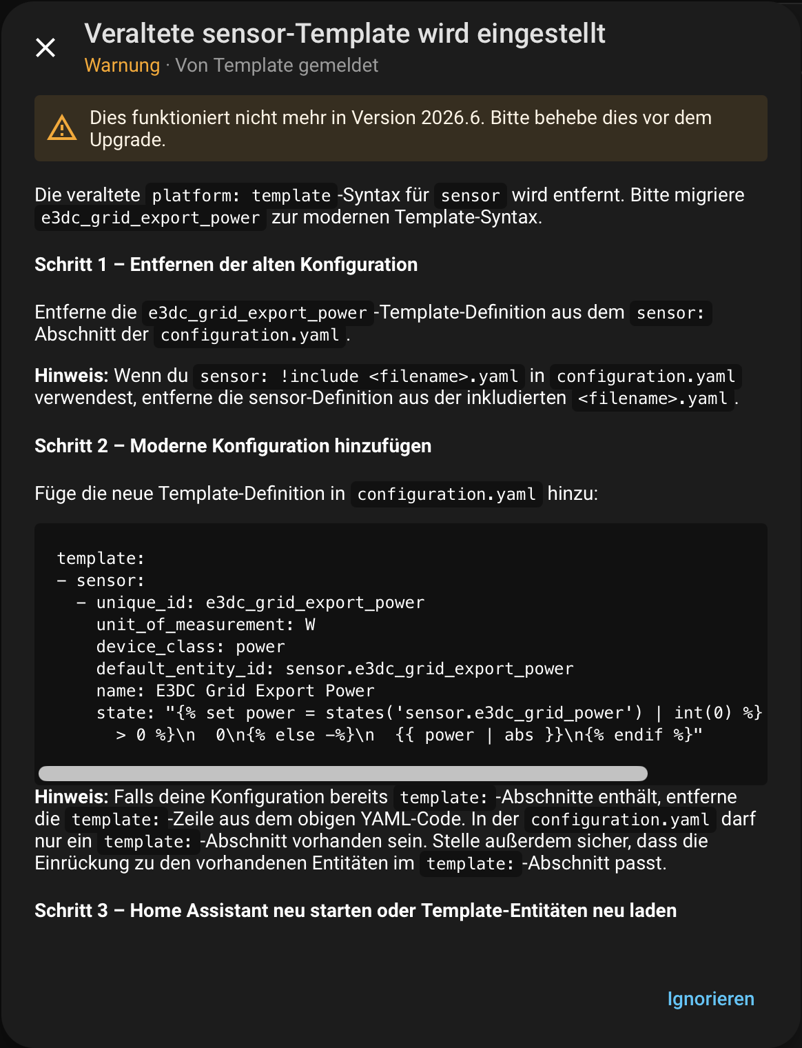

Hi everyone,

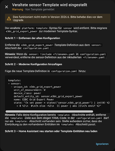

I have 7 repairs mentioned regarding E3DC (my solar power system) sensor templates. I tried editing the templates to the new syntax, but I failed miserably because I just don’t get it.
The mentioned repairs need to be done at /homeassistant/packages/e3dc/sensors.yaml and all read like this:
Below is the current content of the sensors.yaml:

I began cautious and just tried changing the first entry (e3dc grid export power), but it won’t let me reboot HA due to a misconfiguration error. After playing around with the indentations it would let me reboot, but the corresponding entity then says “not found”.
I have for now reverted the file to its previous state. Maybe someone can explain to me what exactly I have to do? Thanks!

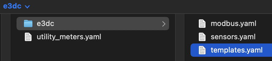

Make a new file in that directory next to sensor.yaml named templates.yaml and in that file do
e3dc_sensors:
  template:
put all your migrated templates in there. You’ll likely need to add 2 spaces in front of every line and only copy past the template: line (do not include it in the copy/paste).

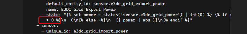

I just did as suggested and it seems to be working. I created templates.yaml
and put all the repair suggestions in there with only 1 template: section and hopefully correct indentation:
e3dc_sensors:
  template:
    - sensor:
      - unique_id: e3dc_grid_export_power
        unit_of_measurement: W
        device_class: power
        default_entity_id: sensor.e3dc_grid_export_power
        name: E3DC Grid Export Power
        state: "{% set power = states('sensor.e3dc_grid_power') | int(0) %} {% if power
        > 0 %}\n  0\n{% else -%}\n  {{ power | abs }}\n{% endif %}"

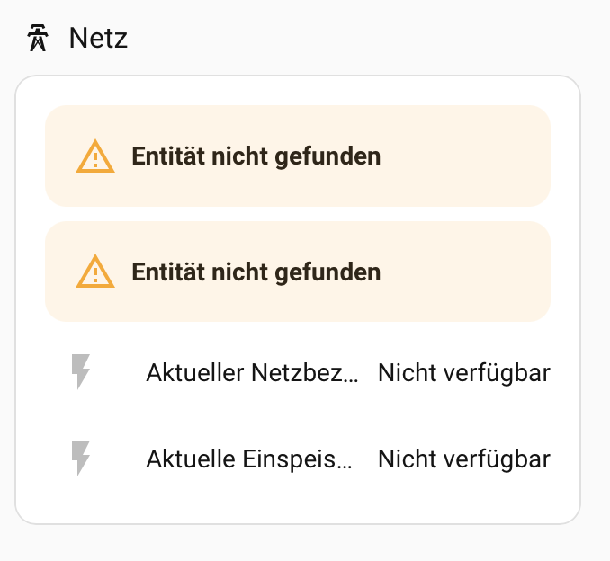

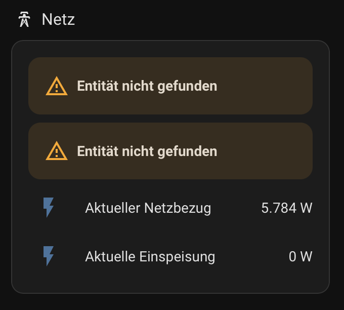

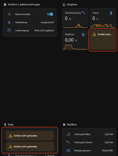

EDIT: HA did no longer offer any repairs after reboot, but some of my e3dc entities stopped working:
Hi everyone.
In the meantime I tested what happens if I remove the old syntax from homeassistant/packages/e3dc/sensors.yaml. I did remove this and rebooted, but nothing changed. I suppose HA already did ignore this part as soon as I made available homeassistant/packages/e3dc/templates.yaml with the suggested new syntax in it.
So some entities are still missing now and I’m not sure why. They do return if I revert to the deprecated way. What should I look at or try next?

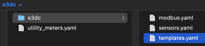

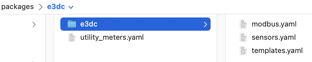

/homeassistant/packages/ contains:

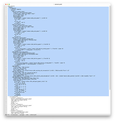

My /homeassistant/packages/e3dc/sensors.yaml:
e3dc_sensors:
  sensor:
    # Templates
    - platform: template
      sensors:
        e3dc_grid_export_power:
          friendly_name: "E3DC Grid Export Power"
          unit_of_measurement: "W"
          device_class: power
          value_template: >
            {% if power > 0 %}
              0
            {% else -%}
              {{ power | abs }}
            {% endif %}
        e3dc_grid_import_power:
          unique_id: e3dc_grid_import_power
          friendly_name: E3DC Grid Import Power

Removing everything above # Integrations and rebooting gets rid of the 7 repairs being mentioned, but results in some entities no longer working:
This (no repairs mentioned + the entities no longer showing up) does not change when I supply the new file /homeassistant/packages/e3dc/templates.yaml containing the suggested changes from the mentioned repairs:

You don’t have unique_id’s, are you restarting or reloading? You need to restart.
Secondly, your first 2 sensors have the wrong indentation. Did you copy/paste directly from the repair? The repair would not have output the data like it’s shown in your file.
There would be 2 spaces in front of that at a minimum, like your others.

But unfortunately entities are still missing. The upper 2 in this screenshot
are e3dc_grid_import_energy and e3dc_grid_export_energy
When I delete the new templates.yaml and revert sensors.yaml to its previous state, they will show up again after a reboot.
I’m not sure what to tell you.
There is something that you’re doing wrong here. Either looking at the wrong entities, or the include isn’t being included in the way you think it is, or there’s errors in the logs. So far you’re refuting all of those and that’s simply not possible. The only way for things to be “error free” is if they aren’t included correctly or they are working.
at this point, if what you’re saying is true, the only thing that can be the cause is your inclusion method. I’d revisit the documents and make sure you’re including things properly with include_dir_merge_named
I really appreciate your help. I never changed or edited anything in HA manually before, everything I use has been installed using the GUI only so no special/manual configuration took place.

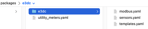

The newly created templates.yaml seems to be included, because HA refuses a reboot when I edit something wrong in it and because the repair errors go away once it exists.
Just to clarify: I created the new templates.yaml and put all the repair suggestions in it as seen in my prior post. I also removed the old stuff from sensors.yaml, meaning I deleted everything above # Integrations so it currently looks like this:

Do I need to move this content to the new templates.yaml file as well? Should I delete sensors.yaml then? Currently I have these:
I’m sorry, but I’m still not understanding this. If I do as suggested with the additional templates.yaml file containing the suggested “repairs” some of the e3dc entities will show up as missing. Once I revert all my changes to the “repairs needed” state they will show up and work again.
I think we’re close to a solution, but one step seems missing and I do not know HA well enough to find that out on my own.
Hi poenn,
I was stumbling over the same issue and I think, I got it solved. Hopefully this will help you and everyone having trouble solving this.
I think you have two issues:
  1. in your new file template.yaml you configure each sensor with an own “sensor:” object. In fact, all sensors should be within one sensor object.
  2. it seems that the original repair instructions from HA were not correct. For me it gave these instructions:
  • sensor:
    • unit_of_measurement: W
      default_entity_id: sensor.e3dc_external_power
      name: E3DC External Power
      state: ‘{ states(’‘sensor.e3dc_external_power’‘) | float | abs }}’
      if you take a close look, there is one “{” missing before “states”. Thus, the file would be corrupt.
      So I corrected all this and have this new sensors.yaml file created. Check out if it helps for you:
e3dc_sensors:
  template:
    - sensor:
        - name: "E3DC External Power"
          state: "{{ states('sensor.e3dc_external_power') | float(0) | abs }}"
        - name: "E3DC Grid Export Power"
          device_class: power
          state: >
            {% if power > 0 %}
              0
            {% else %}
              {{ power | abs }}
            {% endif %}
        - name: "E3DC Grid Import Power"
          device_class: power
          state: >
            {% if power > 0 %}
              {{ power }}
            {% else %}
              0
            {% endif %}
        - name: "E3DC Battery Charging Power"
          unique_id: e3dc_battery_charge_power
          device_class: power
          state: >
            {% set power = states('sensor.e3dc_battery_power') | float(0) %}
            {% if power >= 0 %}
              {{ power }}
            {% else %}
              {% set charge_power = states('sensor.e3dc_battery_charge_power') | float(0) + power %}
              {{ charge_power if charge_power > 0 else 0 }}
            {% endif %}
        - name: "E3DC Battery Discharging Power"
          unique_id: e3dc_battery_discharge_power
          device_class: power
          state: >
            {% if power <= 0 %}
              {{ power | abs }}
            {% else %}
              {% set discharge_power = states('sensor.e3dc_battery_charge_power') | float(0) - power %}
              {{ discharge_power if discharge_power > 0 else 0 }}
            {% endif %}
        - name: "E3DC Autarky"
          unique_id: e3dc_autarky
          unit_of_measurement: "%"
          state: "{{ (states('sensor.e3dc_autarky_and_consumption') | int(0) / 256) | round(0, 'floor') }}"
        - name: "E3DC Own Consumption Ratio"
          unique_id: e3dc_own_consumption_ratio
          state: >
                 - states('sensor.e3dc_autarky') | int(0)
                ) * 256
        - name: "E3DC Emergency Power State Text"
          unique_id: e3dc_emergency_power_state_text
          state: >
            {% set eps = states('sensor.e3dc_emergency_power_state') %}
            {% if eps == '0' %}
              nicht unterstützt
            {% elif eps == '1' %}
              aktiv
            {% elif eps == '2' %}
              inaktiv
            {% elif eps == '3' %}
              nicht verfügbar
            {% elif eps == '4' %}
              falsche Position
            {% else %}
              unbekannt
            {% endif %}
        - name: "E3DC SG Ready State Text"
          unique_id: e3dc_sg_ready_state_text
          state: >
            {% set sgrs = states('sensor.e3dc_sg_ready_state') %}
            {% if sgrs == '1' %}
              sperrbetrieb
            {% elif sgrs == '2' %}
              normalbetrieb
            {% elif sgrs == '3' %}
              pv-überschussbetrieb
            {% elif sgrs == '4' %}
              betrieb für abriegelung
            {% else %}
              unbekannt
            {% endif %}

I just tried it and replaced the contents of my /homeassistant/packages/e3dc/sensors.yaml with the code you provided. One restart later it sadly is the same outcome as with my own attempts:
The repair errors are gone, but 3 entities are missing.
The missing entities are:
sensor.e3dc_battery_discharge_energy
sensor.e3dc_grid_import_energy
sensor.e3dc_grid_export_energy
If I revert the changes, they will return as will the repair errors. Do you have any idea what might be causing this?
yes, I think your dashboard is referencing the wrong entities. Maybe in the previous version they were named like you say. But with the new ones (check the file I provided), they are called differently.
e.g.
is named
now.
So just replace the word “energy” with “power” in your dashboard entity referencing and then it should find them.
