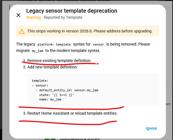

Deprecation of legacy template entities in 2025.12
  1. remove
  1. add new to configuration.yaml, not your sensor file.
  1. restart HA.
See the gotcha’s in the main post about combining multiple.

You can’t… You have to add it to configuration.yaml. It’s a new section, template:, not sensor:
yes, got this now. That was the answer of my original question :slight_smile:
Thx a lot for the help! Just didnt see the difference bindings here and the change from sensor to template
You can still use !include with the new format template sensors. you simply replace add to configuration.yaml:
template: !include templates.yaml

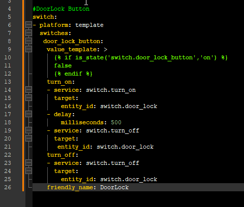

Hello, I need some help.
I have a switch template like below and cen’t get it to work with the repair.
Replace that entire yaml you posted with the yaml from the repair.
I did and the switch stopped working for me.

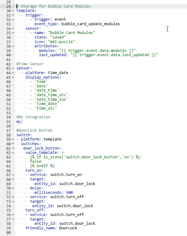

Do you have another template section? Please read the main post and the common issues
Is it because I have another template in the configuration.yaml?
Should I move both to template.yaml and specify the file in configuration.yaml?
Sorry for the dumb questions, but I’m new to this.
