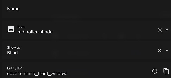

The original entity id should be in your gui and automations.
Yeah they are and look to be correct. For example:
