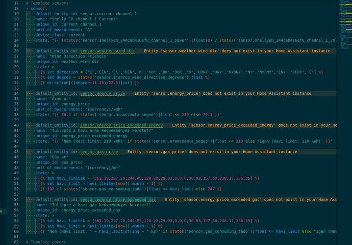

I delete entities from old file (sensors.yaml for example) but now new ones are not created, if restart my HA
Do you have a template section?
yes i have a templates.yaml file and the include are exist in main configuration.yaml.
These entities are not showing:
binary_sensor.wc_mozgas_seged
sensor.weather_wind_dir
sensor.energy_price
sensor.energy_price_exceeded_energy
sensor.gas_price
sensor.energy_price_exceeded_gas
Others seems exist.
Visual studio code also show these:
You need the template: section in configuration.yaml. Do you have that key in configuration.yaml?
Do you have more than 1 template section?
