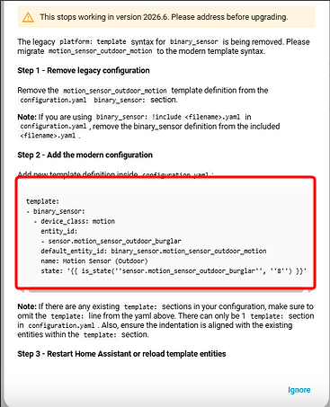

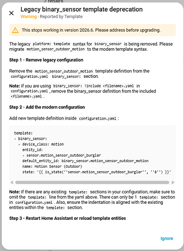

I’ve attempted to read everything here. I’ve gone through the migration using the integration, it makes sense. All except for the platform template sensors that HA identified, and the new migrated sensors that were created:
Repair notice:
Newly-created sensors in config\migrated_templates:
Is this just advisory? Because these sensors don’t exist anywhere in my original configuration. I don’t have a sensor.motion_sensor_outdoor_burglar anywhere. Here’s the relevant section of my configuration.yaml:

I’ve just commented out the migrated sensor line because the new sensors don’t make any sense. The repair notifications remain, though. That’s the weird part… because they point to sensors that don’t exist.

The only way this configuration:
was generated, was if your legacy sensor had entity_id in it.
That field in legacy sensors was deprecated in mid 2020 and it was never introduced in the modern template style.
They are coming from somewhere. The template integration is receiving them from something, possibly a package you don’t remember using?
Nothing you need to check out here, this was a bug that was discovered this morning and a fix is in the works.
I believe that. I’ve just exhausted all means of finding them. And I’ve never defined those sensors manually. I’ve looked in Dev Tools - > States and searched for entities with all filters removed. Studio Code Server came up empty. The only evidence of their existence is in the repair notification and now the migrated_sensors folder.
You’d think Spook would find them. They’re not in use anywhere… I run a pretty tidy HA installation and it’s aggravating that there’s something like this hanging out somewhere.

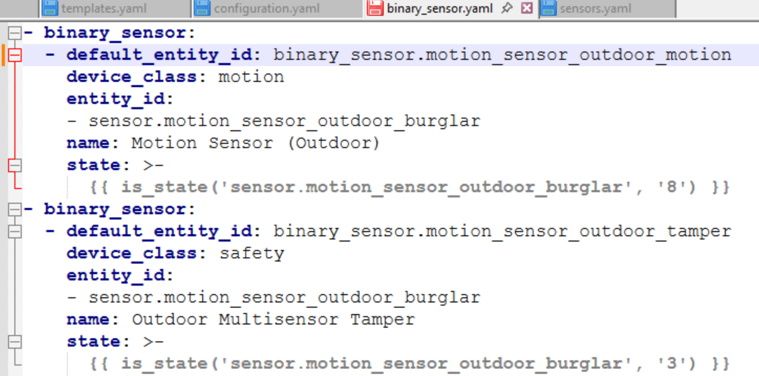

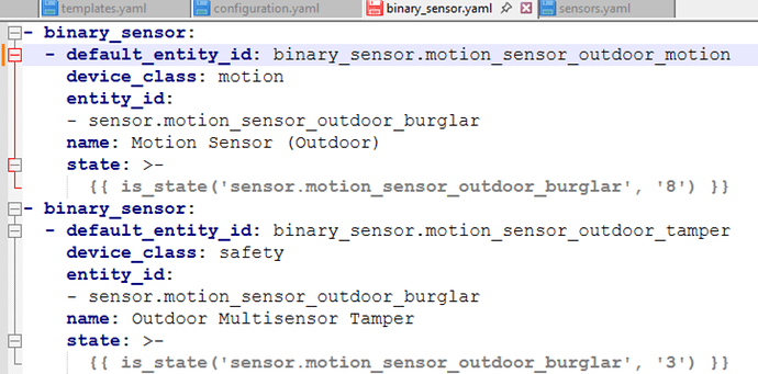

I’ve just found this file in config\packages:
outdoor_motion_sensor.yaml
Here are its contents:
#sensor:
#  - platform: template
#    sensors:
#      motion_sensor_outdoor_battery:
#        friendly_name: "Outdoor Multisensor Battery"
#        value_template: "{% if states.zwave.motion_sensor_outdoor %}
#            {{ states.zwave.motion_sensor_outdoor.attributes.battery_level }}
#          {% else %}
#            unknown
#          {% endif %}"
#        unit_of_measurement: '%'
#        # entity_id: zwave.motion_sensor_outdoor
#        icon_template: >-
#          {% set battery_level = states('sensor.motion_sensor_outdoor_battery')|int('unknown') %}
#          {% set battery_round = (battery_level|int / 10)|int * 10 %}
#          {% if battery_level == 'unknown' %}
#            mdi:battery-unknown
#          {% else %}
#            {% if battery_round >= 100 %}
#              mdi:battery
#            {% elif battery_round > 0 %}
#              mdi:battery-{{ battery_round }}
#            {% else %}
#              mdi:battery-alert
#            {% endif %}
#          {% endif %}
#        entity_id: sensor.time
binary_sensor:
    sensors:
      motion_sensor_outdoor_motion:
        value_template: "{{ is_state('sensor.motion_sensor_outdoor_burglar', '8') }}"
        friendly_name: "Motion Sensor (Outdoor)"
        device_class: motion
        entity_id:  sensor.motion_sensor_outdoor_burglar
      motion_sensor_outdoor_tamper:
        value_template: "{{ is_state('sensor.motion_sensor_outdoor_burglar', '3') }}"
        friendly_name: "Outdoor Multisensor Tamper"
        device_class: safety
Clearly, this is where it’s coming from. I have no idea what package this could have been associated with. I have only two files in the packages folder, and neither of them are valid. These files are included in configuration.yaml here:
