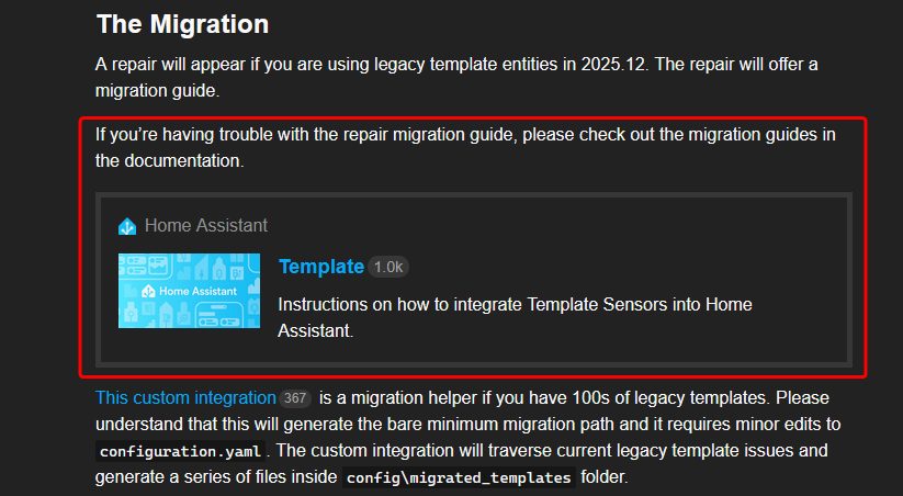

Which migration guide did you choose? There are 3 and each one is tailored towards possible existing configurations with step by step instructions on what to do.
I wasn’t given an option of three imgrations. I ran the action in the Developer Tools and it gave me two lines of code.
Then you haven’t looked at the guides I’m talking about that are linked in this post.
I followed every step on this guide:
That is the custom integration. You’re asking questions that are answered in the official guides.
Well I looked through the official guide and I’m having trouble what lines of code need to be added or swapped. It’s not as straightforward for me at the very least so I tried the Migration tool so I could at least understand what needed to be deleted or added. I have no issue doing it manually, but I’m clearly not seeing the concept here.
The custom integration migration tool does everything for you, including add all the files. The only thing it does not do is remove the legacy configuration, which you have to do manually.

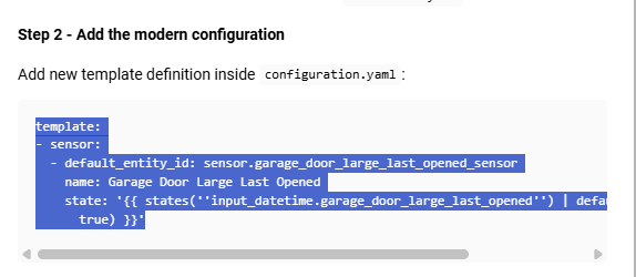

I’m confused here - need some help. Best I can tell I followed the recommendation provided verbatim, but I’m getting a "entity - ā€˜sensor…’ does not exist’ message in my configuration.yaml. See below
Here’s the recommendation from the system - think I added it as it states. What am I missing?
Should be safe to ignore the warning. It’s been stated multiple times in this thread that yaml parsers like VSCode haven’t been updated and throw false alerts.
EDIT: it’ll exist once you restart HA.

Use the documentation linked in the top of this post. There are 3 guides, choose the guide based on your current configuration.

I’m frustrated because I can see you did not click on the link, that tells me you haven’t used the guides in the official documentation on home-assistant.io.
Here’s the link again.
Please try to use those guides before asking questions. And if you have problems, mention which guide you’re using (there is 3 of them) and what you’re confused about.
