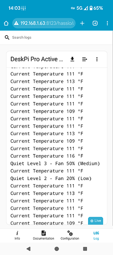

OK … Success!
It was the protection mode switch - “If it was a snake it would have bit me!”
DeskPi Fan_Fix
DeskPi Fan_Working
Thanks for a Great set of AddOns!
