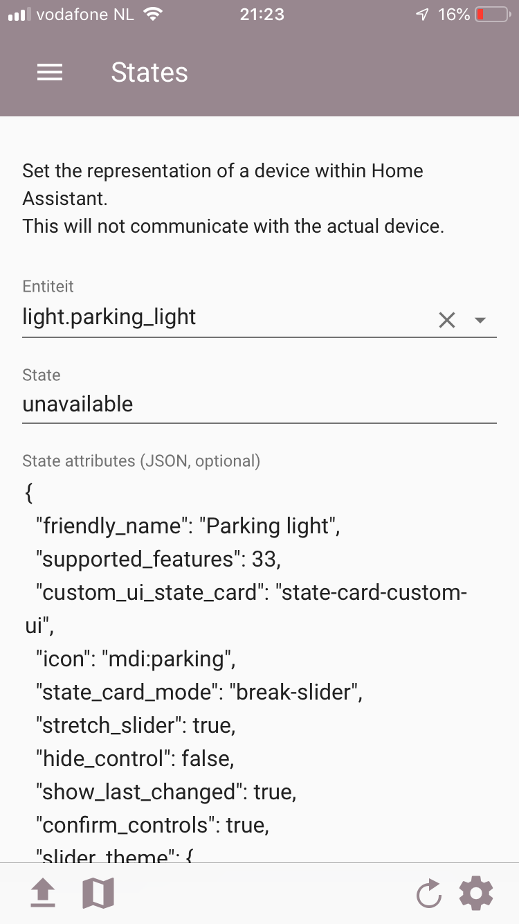

Well, what can I see, it does in my setup
This light is cutoff power daily and set to unavailable using this automation.
