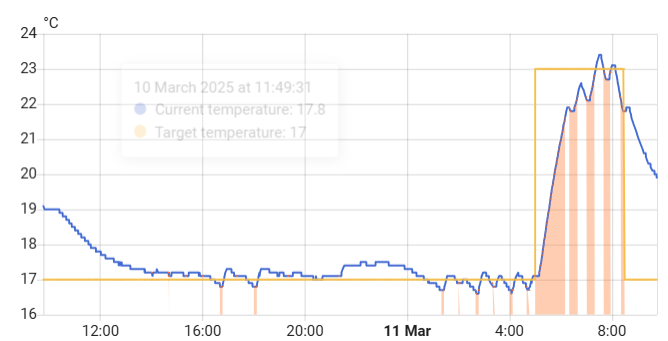

On a different note, is the “Forecast” feature working for you? When enabled, the thermostat should decide when to start warming up the room to reach the target temperature at the specified time. When it is disabled, it starts warming up the room at the specified time. I have it enabled (double-checked in the Devi app), but it always just starts warming up the room at the specified time, as if the feature is disabled.
