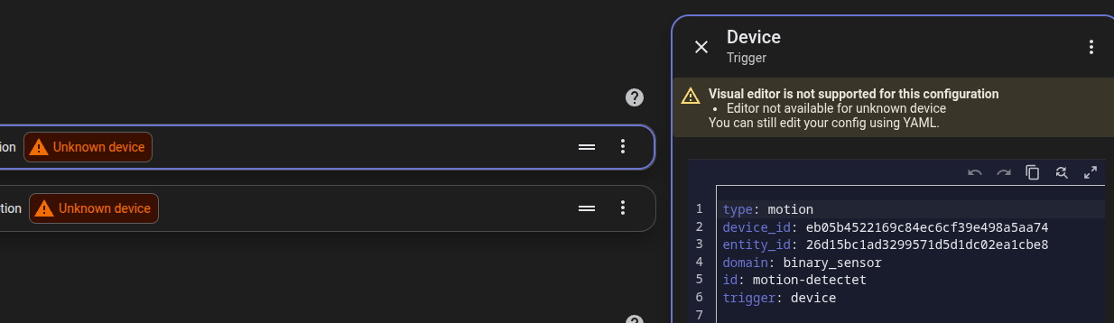

Have removed a device and put in a new one. Existing automation warns with sign “Unknown Device”. The automations jump into the yaml editor, where i see the old device_id and entity_id. I’m able to change these numbers.
But the number of my new device is nowhere to see… Joke or???
