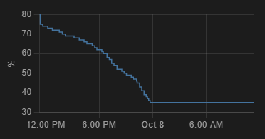

It seems, the app now stopped transmitting any data at all.
Location:
Battery:
So I will try to start over later today. :unamused:
