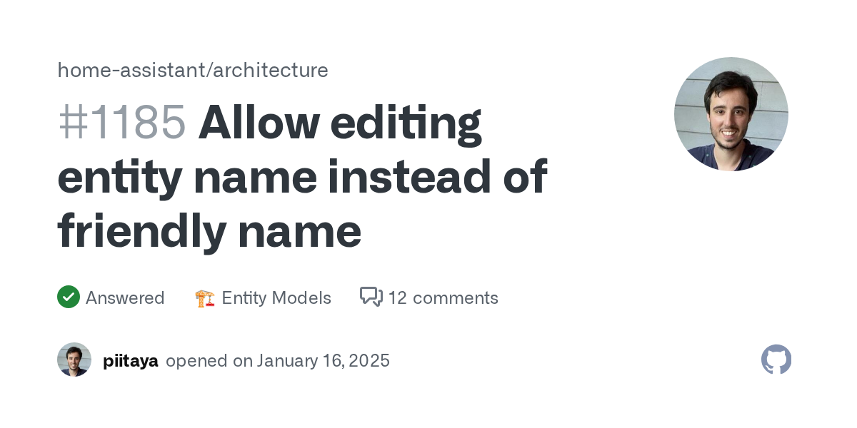

It wasn’t mentioned in the architecture discussion: Allow editing entity name instead of friendly name · home-assistant/architecture · Discussion #1185
