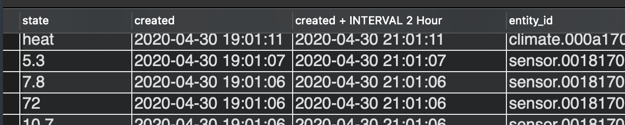

As you can see in the screenshot, the log files show different timezones.
The correct time is in the log file, the container is wrong and two hours behind.

All these starts have no effect. Still wrong. You could say it doesn’t matter here but the main problem is, that the data in the database is wrong, too.
I’m using MariaDB on Synology, but not I docker, I use the package. The Timezone in MariaDB is set to “System”.
Whenever I query for some data from HomeAssistant.states ´, I have to add the correct amount of hours compared to UTC-Time.

“Interval + 2 hours” is the correct local time.
