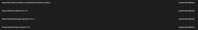

Hi, I uploaded the json file to www folder
and then created the manual card with type: ‘custom:dimmer-button’
but it says Error: Custom element not found: dimmer-button.
Anything else to do . sorry i’m a newbie.

I’m fairly new as well (7 months into HA) and had the same experience as you but I looked at my 2 other Lovelace Resource URL’s for /local/ and they have ?v=#.# appended to then so I gave it a shot and it worked!
Button config is not completed yet but the card works now…
@tonyflowed Can you confirm this is required and if so, update the docs? It looks like the ?v= will take any number but lovelace seems to want something

Are you implying to rename the json file in www folder.
If so I did that and it still ain’t working.
I think its for the version of the component.
Works great when installing it from HACS.
How did you get the weather card with raindrops?
No, not the js file in the www folder, that stays the same. When adding the card resource manually via Configuration, Lovelace Dashboards, Resources, specify the URL like this /local/dimmer-button.js?v=0.1.
Or you can add the card as pointed out by @7even via the HACS Front End, Custom repositories, URL: https://github.com/tonyflowed/dimmer-button, Category: Lovelace.
The installation documentation is really unclear for the less knowledgeable users! Hopefully it’s clearer for you now. It is for me…
