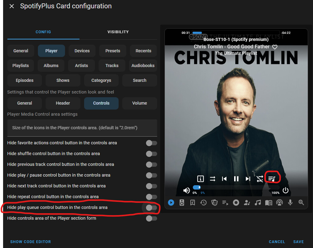

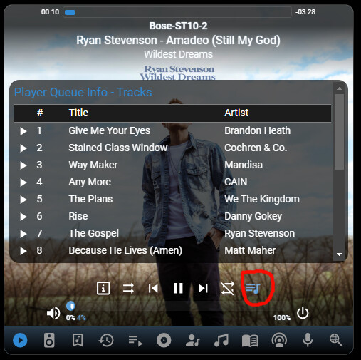

I am trying to figure out how to display my Spotify Queue in my Lovelace dashboard. I’ve managed to integrate the Spotify addon and have tried through the default media player, mini-media player, I’ve managed to get playlists working on there but no display of the upcoming songs… This seems to work through Music Assistant however I am wanting it in a card in an existing dashboard, not have Music Assistant as a whole dashboard itself… Is this possible and if so could someone please point me in the right direction? Thanks
Also, if possible can you get the spotify lyrics in to a card as well? I’ve got this working with genius_lyrics but would be cool to have the karoke style lyrics that you can get in the Spotify app.
I’m trying to get the getQueu functionality into Node Red:
This would allow to create an automation in Node Red to fill a drop-down list in your HA dashboard with all the songs in the queue.
You could even program in Node Red some automation to move in the queue to a song you selected in the drop-down list.
Hi Thomas Lucas,
I’ve been using the standard Spotify integration for years, but yours seems to be able to solve another issue I have of my players becoming unavailable in Home Assistant.
Pretty cool!
Yes Node Red can call HA services.
Looks to be working fine indeed; Thanks for the top tip!
