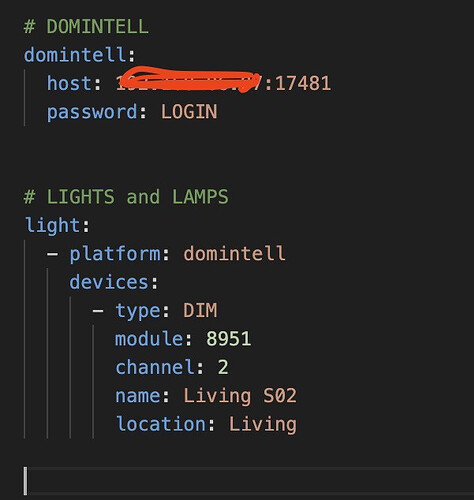

I’m able to access my installation via Domintell GoldenGate software and the Pilot2 app, but can’t get it to work via this Home Assistant custom component in combination with the DGQG04.
Could you provide some insights how you got it to work?
Did you use another port or something else specifically? I tried already using the HEX and decimal address of the module, but neither works to add the lamp.
