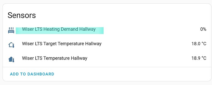

  2. Many of the images on here showing temp, demand etc are either the history more info dialog from the climate device or custom graph cards (downloadable from HACs).
  3. There are sensors for each room that show current temp and demand (see demand as same as valve open %). Screenshot here.
Thanks for your reply, very helpful. I’ve been poking around in the charts and data since yesterday and have a better understanding now.
