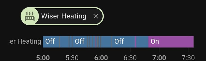

Came home to hub boot looping and not being able to connect to internet. Even while connected to direct wiser wifi it randomly restarts. Unplugging doesn’t help either.
Edit
So it seems to be that every time anything connects to hub either via internal WiFi or normal WiFi hub restarts. Just seen light going green and hub restarting moments later
Edit 2
Seemed to have recovered and settled. Still on 3.10.8 such a behaviour is really unsettling as it was restarting it was causing boiler to cycle.
Edit 3
Hub was unavailable loads of times during the night. In last two hours it gone unavailable (grey lines) for about 10 times :pensive:
