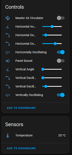

Hello all, I worked my way through a hacking adventure and built a completely cloudcut integration for my Dreo fan (Pilot Max S), via a local ESPHome device:
For those who are interested in getting rid of the cloud portion of the HA integration…
This only works for the DR-HTF004S and is not expected to work on any other fan model. Other fan models would require their own investigative work.
