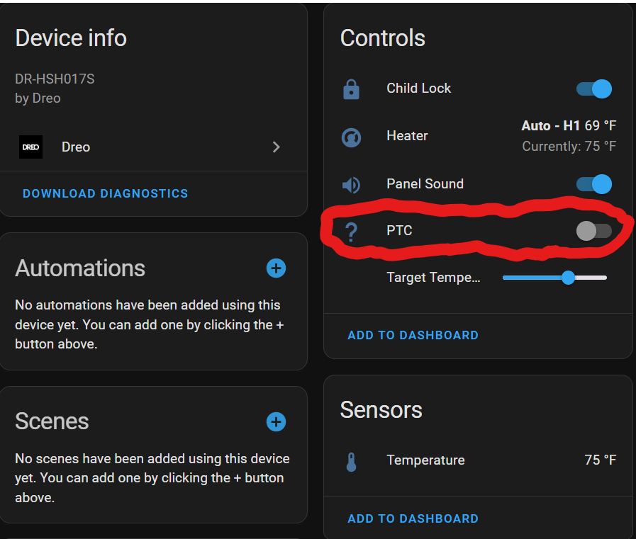

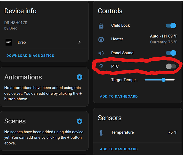

What is the “PTC” function for the Dreo heater integration (what does the entity track and what is the switch supposed to do)? I’ve searched around and can’t seem to find a reference.
Experimenting, turning on the switch doesn’t cause any direct changes for me, it turns off after a short time. Also the PTC “History” shows something turning on/off but it apparently shouldn’t be the actual heating element since the ambient temp is higher then the Auto heat set temp.

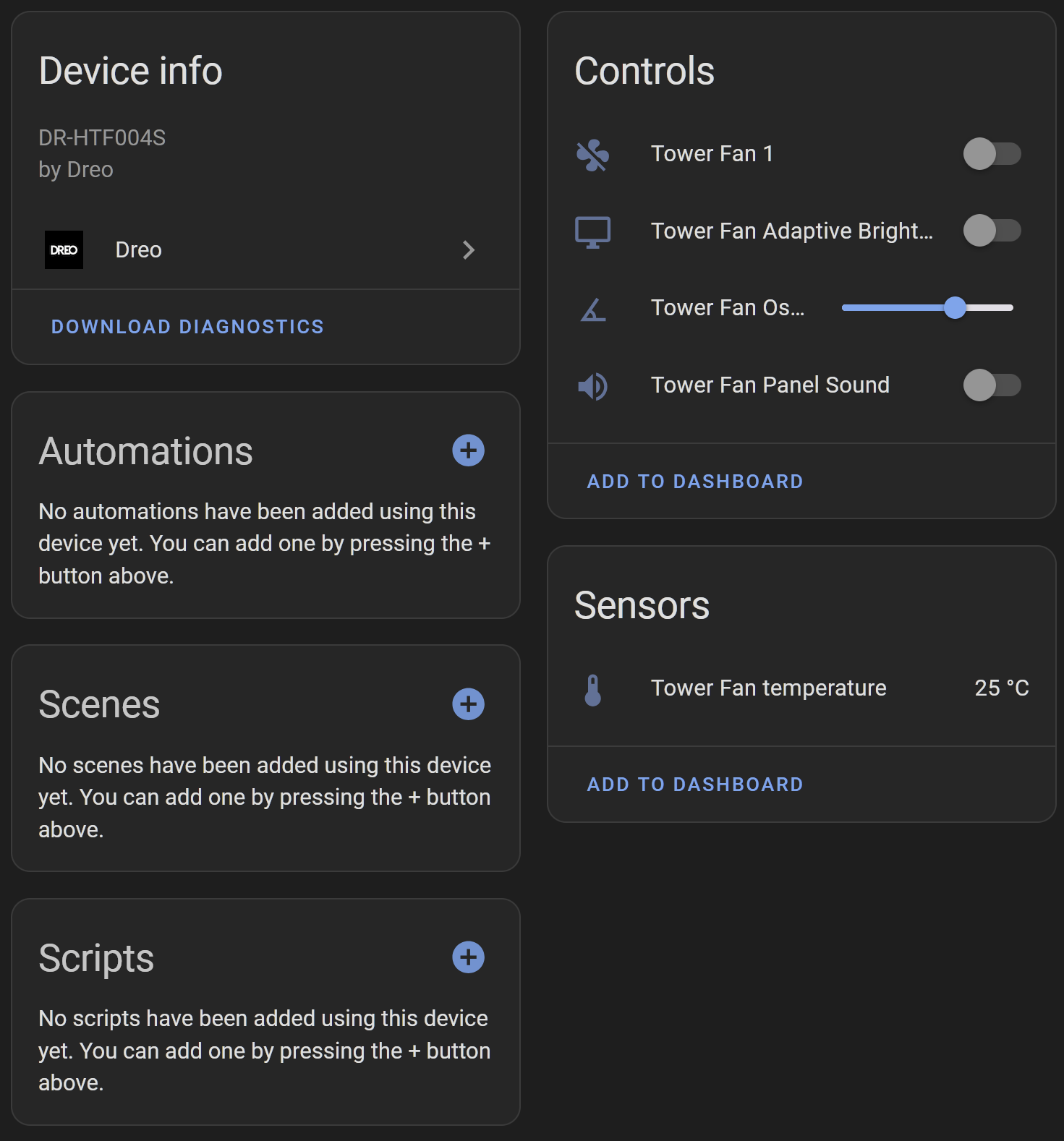

Unclear if this topic is still active. I just got delivery of a Dreo DR-HTF004S and have it integrated into HA. I’m not seeing the different fan modes, just the below. Is that the current limitation of the integration or am I missing something?
Fan modes should be within the Tower Fan 1 Fan entity. Clicking it should bring up a panel with speeds/modes/etc…
Thank you!
