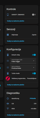

Shelly ZBMiniR2 has “detached relay mode”, which means that input is only reported into HA, but relay is not triggered. Shelly’s button is only reported as binary sensor in HA in that case. (if that’s what you’re looking).
You can still use relay for other things (lights…) by triggering it from HA.
Thank you, i actually bought a Sonoff with relay detach mode, but dont find where is the binary sensor…
Could be that it isn’t reported in HA… on my shelly it’s where all sensors are under zigbee devices (the one with name “Odpiranje”):
