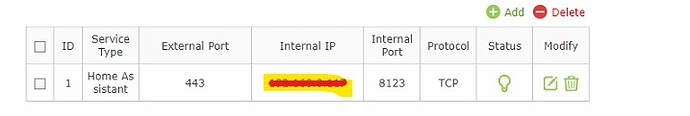

hello developers I have a problem with duck dns I have installed duck dns and nignix proxy and add and modified configuration by putting correct domains and token so my duck dns logs are very correct and working so good same goes to nignix proxy I have put domain in configuration of nignix and copy the proxy of nignix and paste it to configuration.yaml in file editor so everything is fine now when I setup my router setting to port forwarding I used external port 443 to internal 8123 and saved it but whenever I write my domain name.duckdns.org it give me eero secure error.
please help me I am worried.
Are you using Nginx Proxy Manager? Because then you shouldn’t forward to port 8123 in your router, but to 443. And set up the proxy to forward to your HA machine at port 8123

And yes you should port forward 443 to 443 and 80 to 80 (if you haven’t changed the default ports in the NGINX addon)
