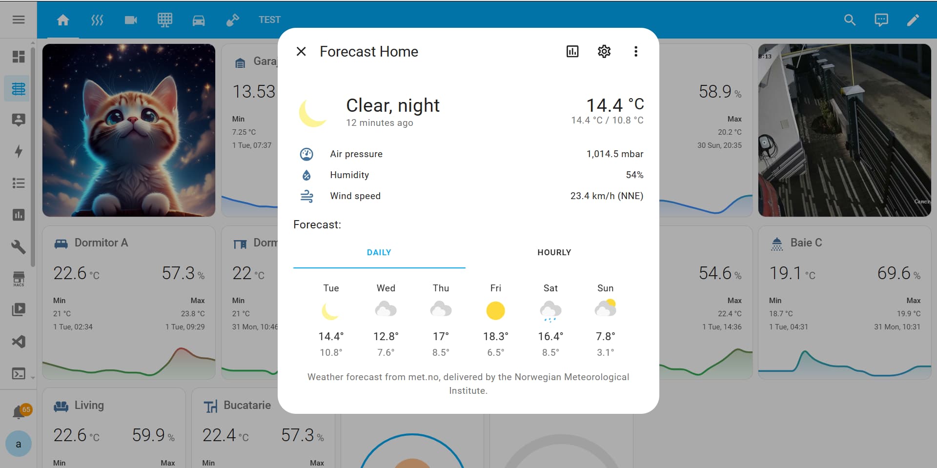

Goal: This guide details how to create a dynamic weather card in Home Assistant. The card’s background image is generated by Google’s Gemini AI based on the current weather conditions and time of day, updating automatically. Clicking the card shows the standard weather entity details.
(This project was developed collaboratively using Home Assistant user ‘kloudy’ idea Weather Dashboard with ChatGPT & DALL-E and Google’s Gemini AI, navigating several technical challenges along the way.)
Example output…
Technologies Used:

  4. Replace the entire content with the following YAML code.
  5. IMPORTANT - EDIT THESE VALUES:
  • Replace weather.forecast_home (used 3 times) with your weather entity ID.
  • Replace YOUR_GOOGLE_API_KEY_HERE with your actual API key string (copied from secrets.yaml or entered directly). Remember the security warning!
  • Replace input_text.gemini_image_timestamp with the entity ID of the helper you created in Step 2.
# Automation YAML
alias: Generate Gemini Weather Image (Hourly + Change)
description: Updates the Gemini AI weather image via PyScript
# Run actions sequentially, dropping older triggers if previous run is still active
mode: queued
max_exceeded: silent
trigger:
  # Trigger 1: Every hour at 1 minute past the hour (adjust trigger time as needed)
  - platform: time_pattern
    hours: "/1"
    minutes: 1
    seconds: 0
  # Trigger 2: When the weather condition state changes
  - platform: state
    entity_id: weather.forecast_home #<-- YOUR WEATHER ENTITY ID HERE
condition: [] # No conditions
action:
  # Action 1: Call the PyScript service to generate/save image
  - service: pyscript.generate_gemini_image
      # Pass current weather state
      condition: "{{ states('weather.forecast_home') }}" #<-- YOUR WEATHER ENTITY ID HERE
      # Pass current temperature attribute
      temperature: "{{ state_attr('weather.forecast_home', 'temperature') | float(0) }}" #<-- YOUR WEATHER ENTITY ID HERE
      # Pass sun state for time of day context
      sun_state: "{{ states('sun.sun') }}"
      # Pass sun elevation for time of day context
      sun_elevation: "{{ state_attr('sun.sun', 'elevation') | float(0) }}"
      # WARNING: API Key in plain text - Less Secure!
      # !!! REPLACE WITH YOUR ACTUAL API KEY !!!
      api_key: "YOUR_GOOGLE_API_KEY_HERE"
  # Action 2: Update the helper text to trigger cache busting in Lovelace
  # This runs AFTER the pyscript service call attempts
  - service: input_text.set_value
      # !!! USE YOUR HELPER'S ENTITY ID !!!
      entity_id: input_text.gemini_image_timestamp
      # Set value to the current timestamp as an integer
      value: "{{ now().timestamp() | int }}"
  # Action 3: Force update the camera entity (Removed - not needed with button-card)
  # We removed the camera_proxy method in favor of button-card + markdown img
  1. Click Save. Name the automation.

Step 4: Create the Lovelace Card
This uses custom:button-card from HACS to display the image dynamically (using the helper for cache busting) and handle the tap action correctly.
  1. Ensure button-card is installed via HACS (see Prerequisites).
  2. Go to your Lovelace dashboard, enter Edit Mode.
  3. Click + ADD CARD.
  4. Choose the “Manual” card type.
  5. Replace the content with the following YAML.
  6. IMPORTANT:
  • Replace weather.forecast_home with your weather entity ID.
  • Replace input_text.gemini_image_timestamp with your helper’s entity ID.
# Lovelace Card using custom:button-card
type: custom:button-card
# Entity used for the more-info tap action context
entity: weather.forecast_home #<-- YOUR WEATHER ENTITY ID
# Hide default button elements
show_name: false
show_icon: false
show_state: false
show_label: false
# Define the tap action for the whole card (opens more-info for the entity above)
tap_action:
  action: more-info
# Style the card itself (remove padding, add border radius matching HA cards)
styles:
  card:
    - padding: "0px"
    - border-radius: "var(--ha-card-border-radius, 12px)"
    - overflow: "hidden" # Hide image corners if they don't fit the radius
# Use custom_fields to inject the HTML for the dynamic image
custom_fields:
  # Define a field named 'img' (can be any name)
  img: >
      // Use button-card's JavaScript templating capability
      // Get the state of the cache-busting helper entity
      const cacheBuster = states['input_text.gemini_image_timestamp'].state; // <-- YOUR HELPER ENTITY ID
      // Construct the img tag. Use Date.now() as a fallback cache value if helper state is briefly unavailable.
      const cacheValue = cacheBuster || Date.now();
      // The image path must match where PyScript saves the file (/config/www -> /local/)
      // style ensures the image fills the card area
      return `<img src="/local/gemini_pyscript_image.png?v=${cacheValue}" style="width: 100%; height: 100%; display: block; object-fit: cover;" alt="Weather Image">`;
  1. Click Save.
  2. Position the card and exit Edit Mode (Done).
Final Result & Next Steps
You should now have a fully functional, dynamic AI weather card! The automation triggers image generation based on time and weather changes, PyScript calls Gemini, the image is saved, the helper forces a cache update, and the button-card displays the latest image and handles clicks correctly.

Did I forget a screenshot? :slight_smile:
Thanks for sharing.

def generate_gemini_image(condition=None, temperature=None, daylight_phase=None, api_key=None):
    Generates an image using the Gemini API (v27.1) based on weather and daylight phase.
    Includes retry logic. Saves main image and optionally archives a copy.
    Args:
        condition (str): Standard HA weather condition.
        temperature (float/int): Current temperature (available for potential future prompt use).
        daylight_phase (str): State from sensor.simple_daylight_phase (Night, Sunrise, Day, Sunset).
        api_key (str): Gemini API Key (passed directly from automation).

Summary of Enhancements Implemented:
This final version includes several refinements compared to a basic setup:
  1. Smarter Triggers: The automation is no longer triggered only periodically. It now triggers more relevantly based on actual changes to the weather entity’s state and significant changes in the time of day detected by the sensor.simple_daylight_phase (catching shifts between Night, Sunrise, Day, Sunset). This provides more timely and context-appropriate image updates.
  2. Enhanced Prompt Context: Dynamic prompts sent to the Gemini API now incorporate time-of-day context derived from the sensor.simple_daylight_phase (e.g., adding “at night, dark scene”, “during a beautiful sunrise with golden hour light”, “bright daytime scene”). This is added alongside the weather condition details, aiming for more atmospheric and correctly lit images.
  3. API Call Robustness: The PyScript code includes a simple retry mechanism. If the initial API call to Gemini fails due to a temporary network error or timeout, the script will wait a few seconds and attempt the call one more time, increasing the chances of success during transient API or network issues.
  4. Manual Trigger: A hold_action (long press) has been added to the Lovelace custom:button-card, allowing users to manually trigger the image generation process on demand directly from the dashboard.
  5. Simplified Daylight Logic: Instead of complex calculations, a simple Home Assistant Template Sensor (sensor.simple_daylight_phase) uses sun.sun state and basic elevation checks to provide distinct Night, Sunrise, Day, and Sunset states, making the PyScript logic for time context cleaner.
  6. Optional Image Archiving: The PyScript includes a flag (archive_images) and logic to optionally save a timestamped copy of each generated image to a separate directory (e.g., /config/www/gemini_archive/), creating a visual history.

    # --- Validate Input Arguments ---
    if not condition: log.error("PyScript: Condition missing!"); return
    if temperature is None: log.error("PyScript: Temperature missing!"); return
    if not daylight_phase: log.error("PyScript: Daylight Phase missing!"); return
    if not api_key: log.error("PyScript: API Key (for ir.myqa.cc) missing!"); return

3. Update Home Assistant Automation:
  • Go to your Home Assistant configuration where the automation that calls the pyscript.generate_gemini_image service is defined (e.g., in automations.yaml).
  • Find the action: section that calls the service.
  • Update the api_key: data field to use your new ir.myqa.cc API key instead of the old Google API key.
4. Reload PyScript:
  • Save the changes to your generate_gemini.py file and your automation configuration.
  • In Home Assistant, go to Configuration → Server Management (or Settings → Server Management) → YAML Configuration → Pyscript (or find the Pyscript integration) and click Reload.
Now, when the automation triggers, it should call the modified PyScript function, which will then contact the ir.myqa.cc API using your new key and the specified model to generate the image. Remember to check the PyScript logs (/config/pyscript.log or via the HA interface) if you encounter issues.
Hope this helps keep your AI weather cards running! :slight_smile:
PS Gemini isn’t working here either, it says I’ve exceeded the daily request limit… Luckily, there are free models like FLUX-1-schnell:free and sdxl-turbo:free. I tried the last one…
PPS Apparently, my daily request quota reset today (looks like it’s 50), so I can use the Gemini model again - but just for 50 requests today :). I’m just changing the model identifier in the script from 'stabilityai/sdxl-turbo:free' to 'google/gemini-2.0-flash-exp:free'.
Thank you very much for the alternative.
2025-04-22 09:47:59.102 ERROR (MainThread) [custom_components.pyscript.file.generate_gemini.generate_gemini_image] Exception in <file.generate_gemini.generate_gemini_image> line 84:
                response = task.executor(requests.post, api_endpoint, headers=headers, json=payload, timeout=240) # Keep long timeout
NameError: name 'requests.post' is not defined
maybe you have a missing “import requests” at the beginning of the script?
Sorry my bad, I should have read the description better. I just replaced the whole script by your modified function.
