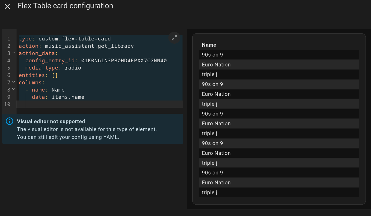

I’m trying it out, but it’s producing duplicate rows for some reason:
type: custom:flex-table-card
action: music_assistant.get_library
action_data:
  config_entry_id: 01K0N61N3PB0HD4FPXX7CGNN40
  media_type: radio
entities: []
columns:
  - name: Name
    data: items.name
Depends on a structure of your source data. Suggest to check a huge existing thread.
Thanks. It was because there were other fields in the response, so it was iterating over both those fields and the items. I made a script to just return the items:
