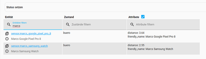

I’m using espresense to detect my devices inside my rooms.
Inside the picture-elements card, is it possible to change the positions (left and top) from a state-badge, state-icon etc. based on a state from one of this espresense entitites?
