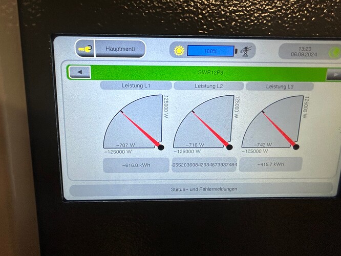

The E3DC integration works very well for me. I have only one thing that would be nice if if is include. I have an external înverter. And this inverter currently has an ugly bug.
Not a problem with the integration. However a problem of the S10X.
For me total power would be sufficient. This is already present in the database. Tag is DB_DC_POWER = Ox06800004. And this one is diplayed correct. One additional line in _load_and_process_db_data_today. And an additional definition in sensor.py. My E3DC is currently delivering bullshit for the external E3DC inverter. I will also trigger the E3DC people.
Best regards
Franz
Forwarding that to E3DC is a good idea.
Without further information it is hard for me to judge what is happening.
I’ve just opened the discussion forums on GitHub (separate announcement will follow shortly). Could you please go to the new help forum and open a thread there? Please include a diagnostic dump.
Cheers, Torben
