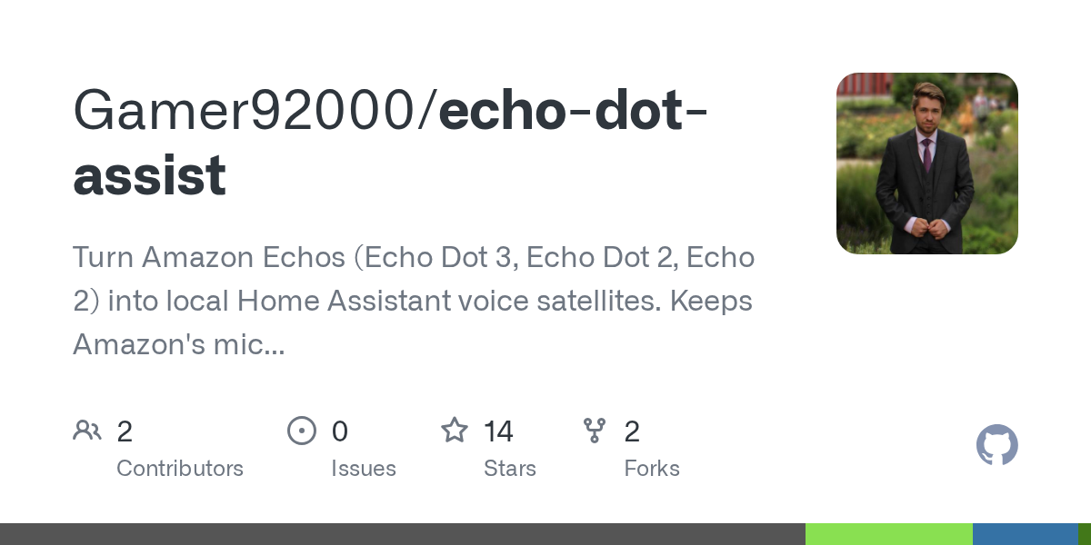

Echo Dot 3rd gen (2018) as a fully local Assist satellite, keeping Amazon's mic array and wake word engine
After I saw that my Echo Dot got rooted I could not resist throwing my clanker at the problem and turning the paperweight into a usable HA voice satellite, while keeping as much of the original audio stack as possible. It has since grown to three Echo models.
Major thanks to @Alessandro_Alfonzett and their work (Re-Using an Echo Dot 3rd gen with Voice Assistant) for inspiring me and for making me aware this was possible.
Which Echos
  • Echo Dot 3rd gen (only 2018): you need to open it and attach wires inside
  • Echo Dot 2nd gen: just a micro-USB cable, no soldering, the easiest one
  • Echo 2nd gen (the tall one): you need to open it and solder a USB cable inside
What you get
  • A voice assistant for Home Assistant that HA finds by itself. You click “add” and it’s there, no YAML.
  • It still hears you like the old Echo did: across the room and over its own music, because Amazon’s microphone processing stays in place.
  • Say “Alexa” like before, or switch it to “Echo”, “Computer”, “Amazon” or “Ziggy” and pick the wake word in HA.
  • Several Echos in the house? Only the one closest to you answers. The others stay quiet.
  • Timers, announcements, follow-up questions. Say “Alexa, stop” to cut off a reply.
  • Works as a media player in HA and as a Music Assistant speaker, including synced multiroom.
  • Bluetooth speaker for your phone (pairing is switched on from HA), and a Bluetooth proxy for your HA devices.
  • Do not disturb, an equalizer and the mic sensitivity are all settings in HA.
  • Buttons, light ring and the mute button behave like you’re used to.
  • It never talks to Amazon: Alexa is switched off and the Echo is blocked from the internet.
  • A guided setup walks you through the install step by step and only stops when you have to do something by hand.
  • Updates come over Wi-Fi after that, and you can go back to stock Alexa.
The catch
  • Unlocking the Echo can brick it, and it needs to be on the exact firmware version the instructions name
  • On the Dot 3 and the Echo 2 you have to open the case and solder or clip wires
  • You need a Linux PC
  • Honest disclaimer: the whole project was written with an AI (Claude), reverse engineering included. It has been tested on exactly one unit of each model: mine. Read what you run.
Repo with full install instructions:
Happy to hear whether it works on your unit, and bug reports are welcome.

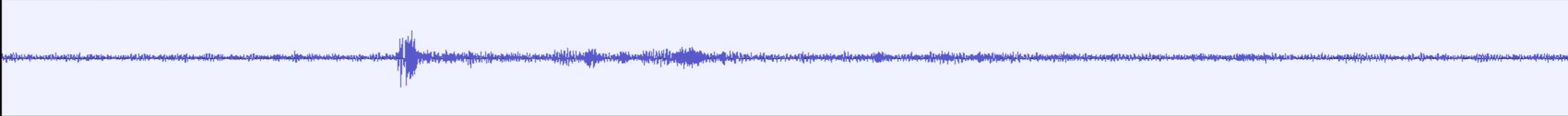

This is better now, but even with max mic level at -15db, this is what I get when sitting next to the Echo Dot and speaking in a quiet room in a low, but comfortable level.
Recording is done by adding this to configuration.yaml:
assist_pipeline:
  debug_recording_dir: /share/assist_pipeline
So the level is higher than with the default setting of -26db, but still very low.
Will try to root another Echo Dot in the next days to see if it behaves similar.
Ok, so I did some more testing and it turns out that for some reason the spoken audio gets treated as background noise and thus is massively reduced in the output signal by the original audio processing logic, before even reaching hassmic.
When speaking from ~ 3 meters quietly with some background noise the current setup has a signal to noise ratio of only around 2 dB. With my crude changes to the ARA config (most likely something like Adaptive Reference Attenuation, their background noise filter) I got the signal to noise ratio to about 9 dB.
I still need to do a lot more testing, especially in different noise environments. But do expect a commit addressing this at the latest in a few days.
