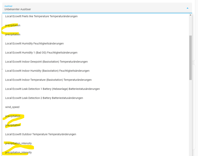

I have the âofficalâ Ecowitt from @pvizeli
After upgrading my HA to a current version my automations all list âunknownâ trigger
when I try to readd the correct trigger I see a lot of duplicates and e.g. wind gust is totally missing
anybody seeing this aswell and a possible solution?

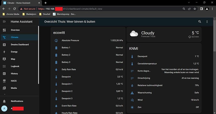

I have an Ecowitt Gateway GW2000 with LAN/Wifi (868MHz to the sensors) connected via the RJ45-LAN to my router and installed succesfully via the Ecowitt WebUI 3 Temperature/humidity sensors type WH31 (multi channel, 868MHz, Temperature/Humidity/Battery 1/2/3, Indoor Dewpoint/Humidity/Temperature). Got âfor freeâ the Weather station from the neighbor, 2 gardens away (Ecowitt âoldieâ WH65, rest of the 868MHz sensors info). The Ecowitt protocol over the 868Mhz freq. is not really secure. I followed the install instruction of the HA site and of the Ecowitt integration.The Ecowitt integration via HACS works fine in HA. See also settings âcustomizedâ screen of Ecowitt WebUI for the upload to my HA.
I have set all other unused sensor options to âdisableâ in the GW2000 gateway via the Ecowitt WebUI, so no more devices/sensors can connect to the GW2000 than the currently linked ones to the gateway. I changed the default automatic link to the Ecowitt Weather site from every â1 min.â to âNeverâ, so there is no more any upload to the Ecowitt weather site! So the GW2000 gateway only uploads to my HA. I do NOT use the Ecowitt Gateway Wifi and the Ecowitt phone App. I can now follow-up all the actual information and history perfectly in HA (WebUI and/or HA App).
The sensor Hut on the foto is not an Ecowitt, but a âTFA  Schutzhulleâ.
